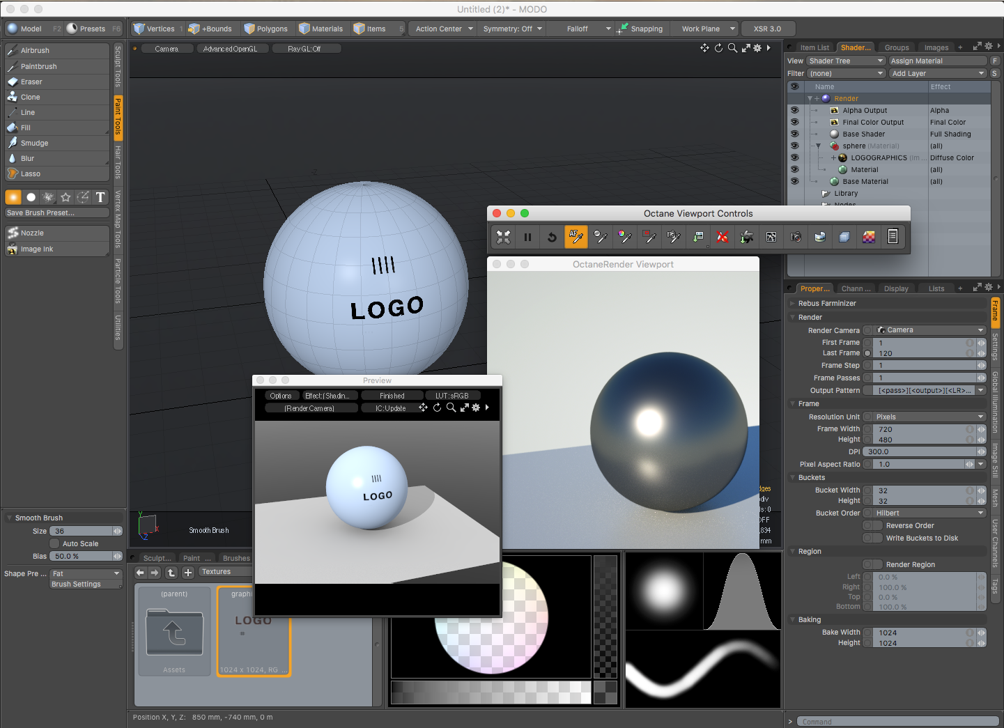

So, here is my example, sphere with a blue material, a texture on top with graphics, attached an image. Octane viewport, shows something dark grey...with no graphics...

Thanks for posting the screenshot. At a guess I would say the Project Type for the texture locator of the image is not set to UV, and is instead set to a non-supported projection. Pls see https://docs.otoy.com/#60Projection%20Mapping for what is and is not supported in this regard. If that does not solve the issue, yes send me the scene and I will take a closer look.
