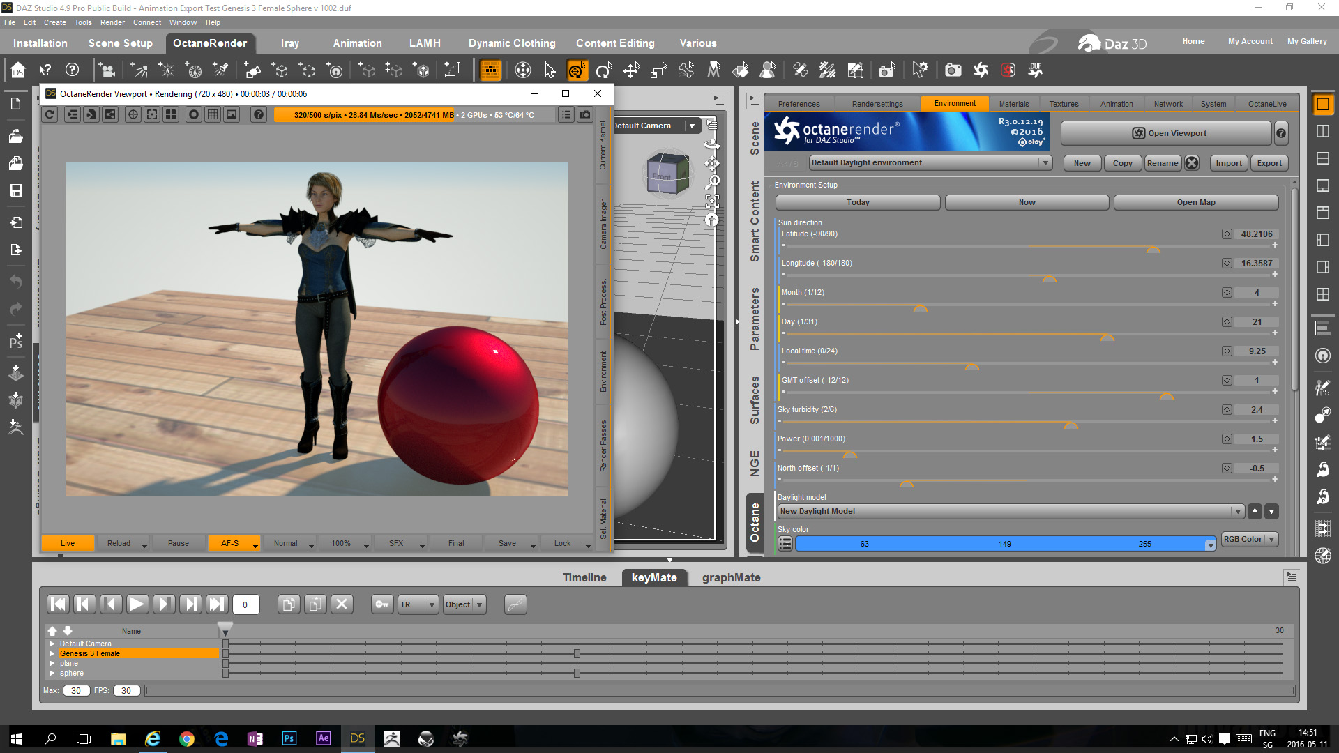

Scene state frame 01

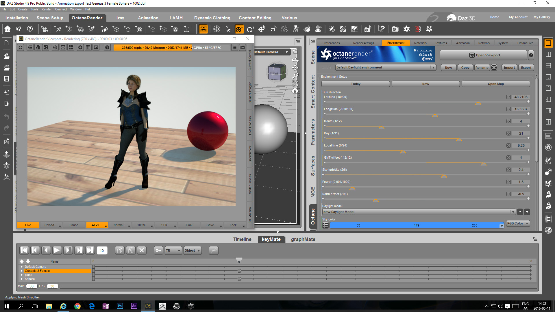

Scene state frame 10

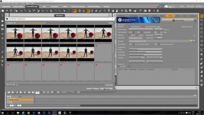

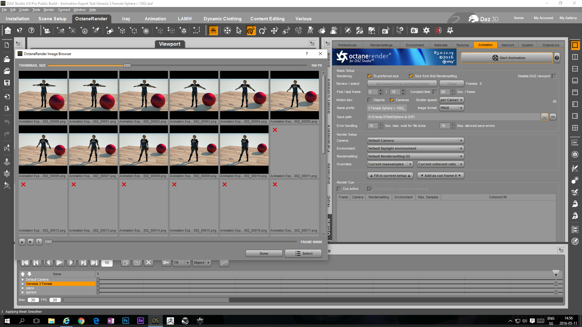

10 Frame Animation rendered properly in OcDS plugin

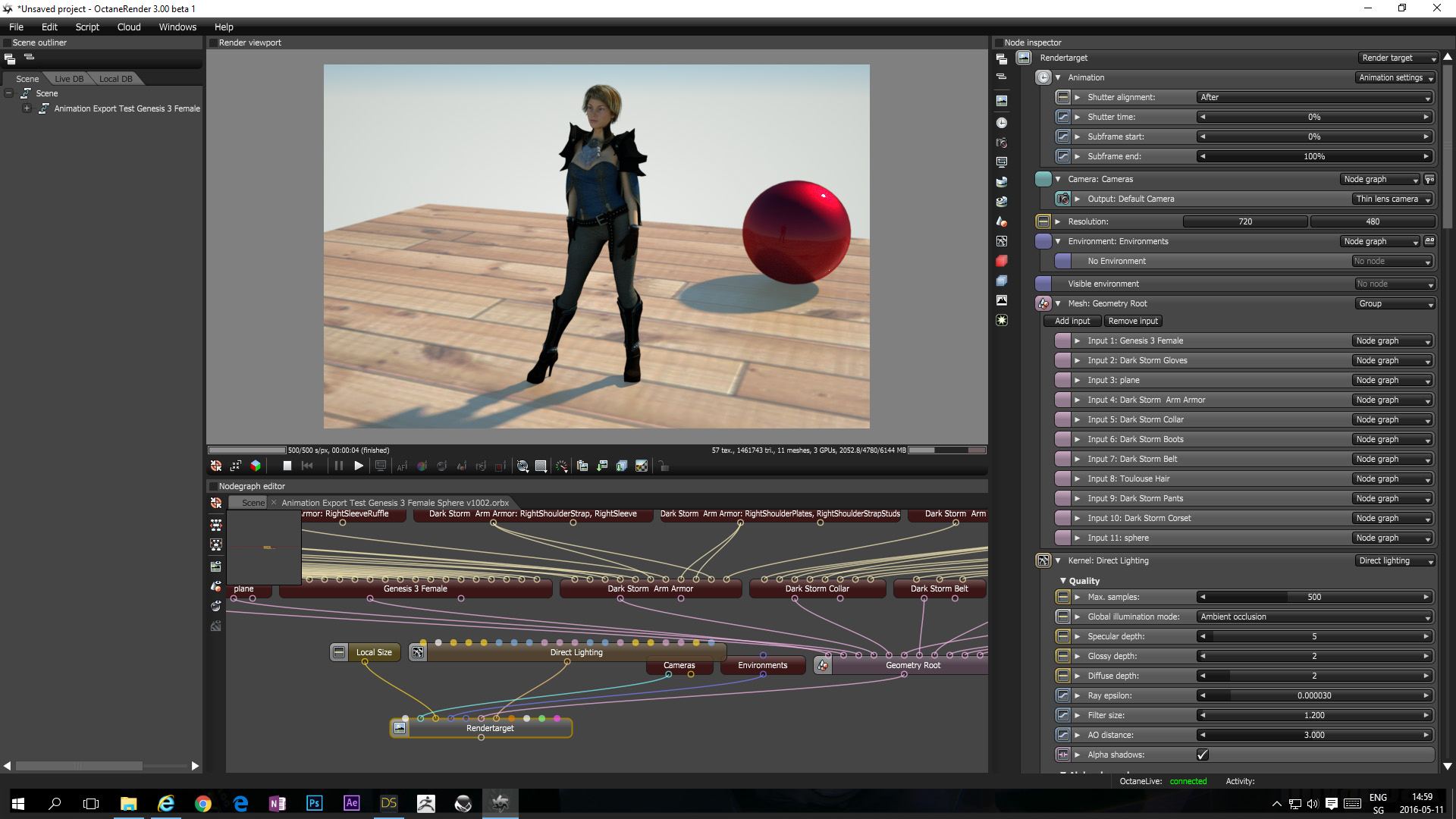

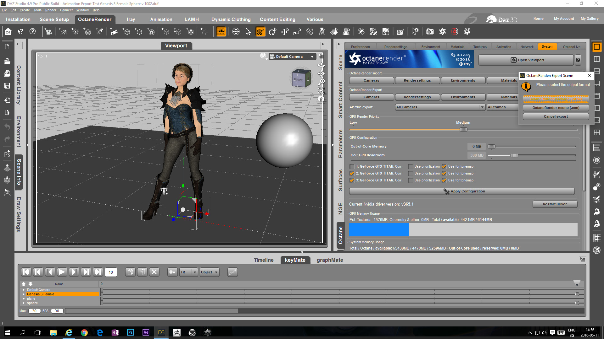

ORBX scene export AFTER viewport was active once
ORBX import in OR standalone - No timeline available

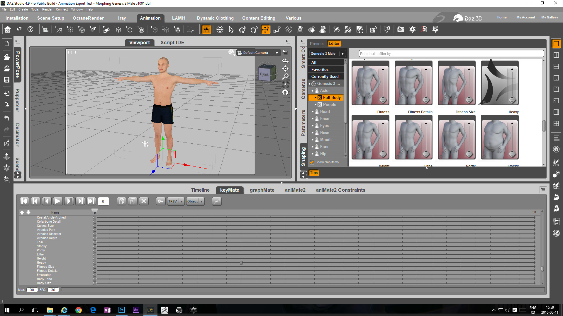

Scene State Frame 01
Make sure to select TRSV in keymate to actually see the morph Values.
It can take some scrolling down to find the Heavy Morph...

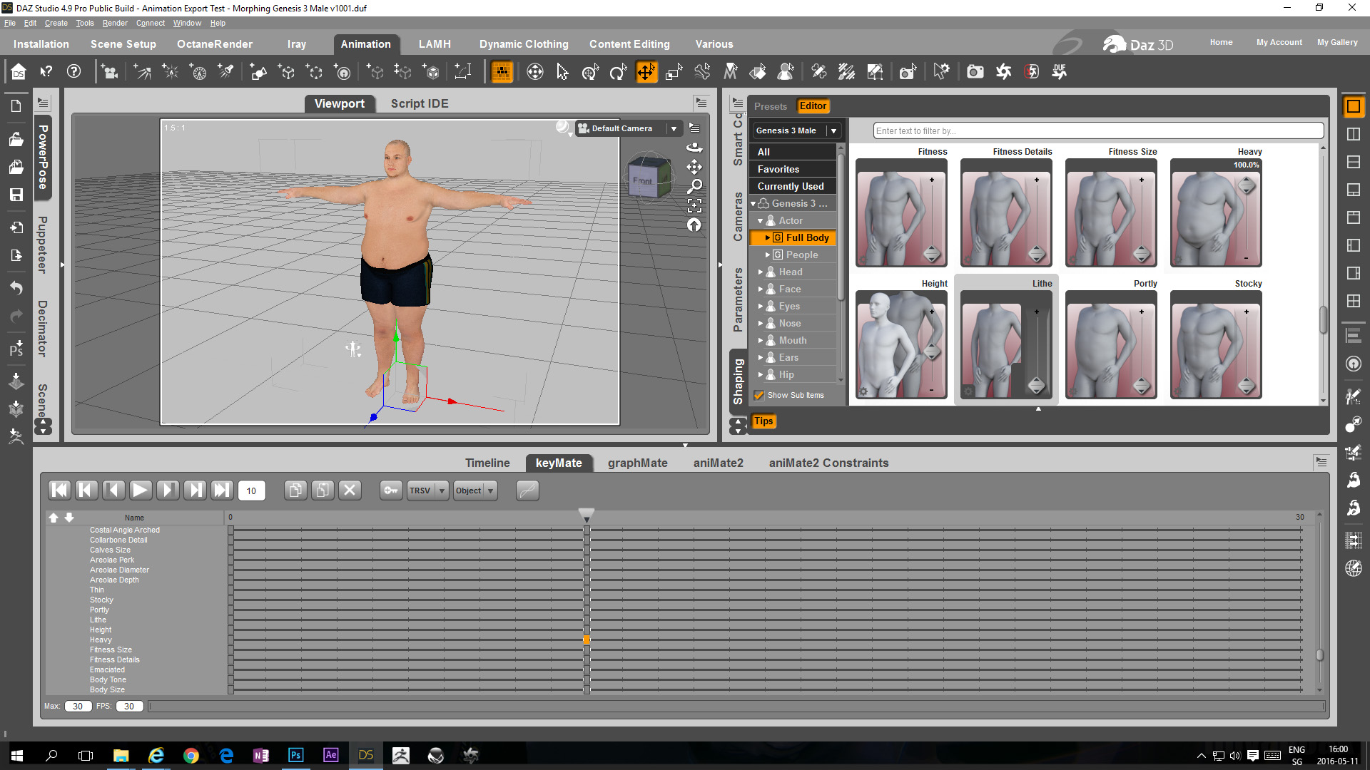

Scene State Frame 10

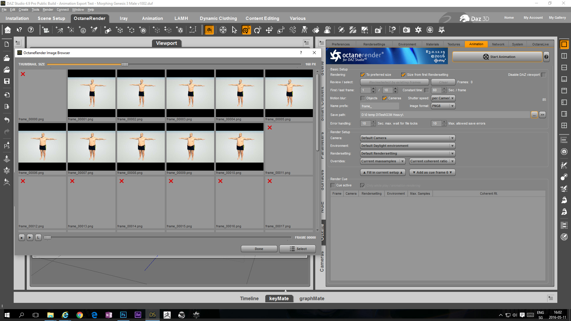

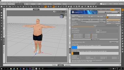

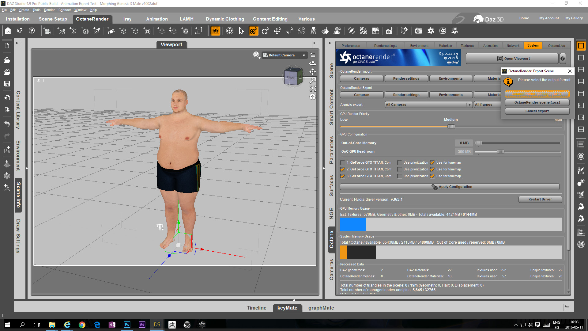

Export Scene as ORBX

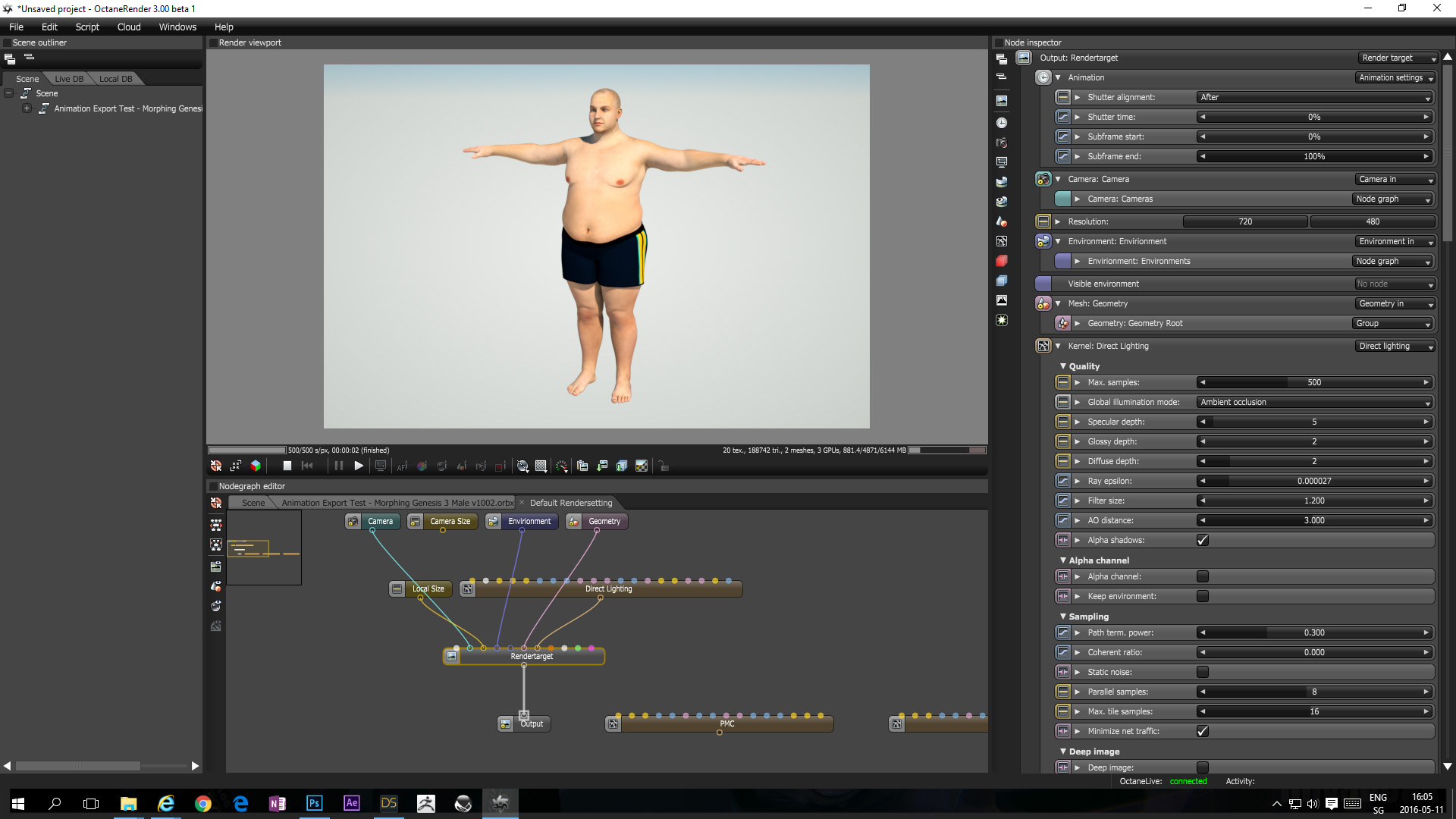

Result:
ORBX Import OR Standalone - No timeline
-> Morph Animations that are detected and working in OcDs do not show up after importing the .ORBX in OR standalone.
The timeline is missing.
