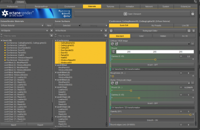

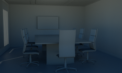

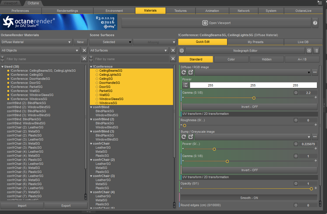

Anyone having this problem. This is new. I see materials in Daz Viewport. Only Character materials rendering. Entire room scene, rendering white. UGH. This just started. Nothing new since last work I did.
Gateway i5 3.2ghz, 16g RAM, GTX 690 4GB VRAM, Windows 10 64bit, Poser Pro 11, DAZ Studio Pro 4.9, Daz Octane Plugin V2, Poser Octane Plugin V2
morphious2013
Posts: 388
Joined: Sat Apr 20, 2013 1:22 pm
It's so weird. I have to reconnect all the textures. The node defaults to a color. Any ideas?

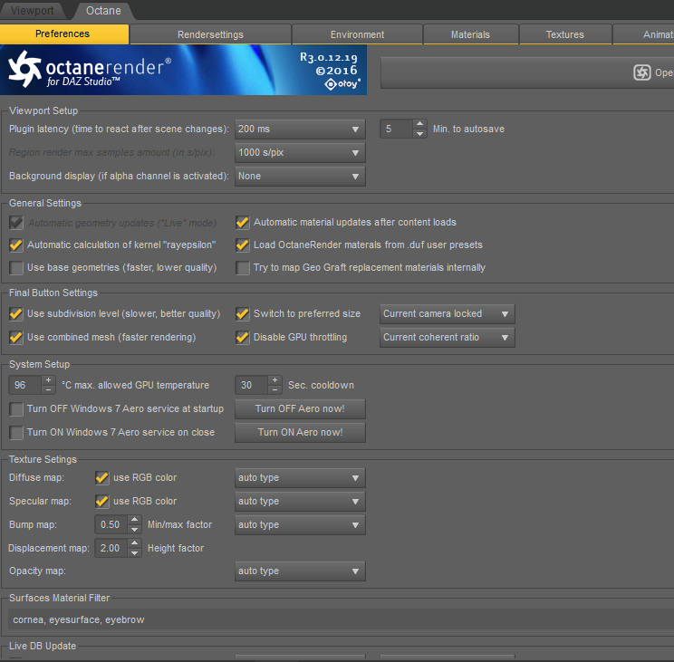

Tick Preferences->"Automatic material updates after content loads", and "Load OctaneRender materials from .duf user presets".

Already checked. I even un/re-installed the room prop. Only V6 and her hair/clothes render with textures. I guess it's just that prop. Doesn't make sense. Other room scenes are fine. UGH WTF. It's an older room prop, but still, don't understand why the textures are being disconnected. Even if I re-connect them, save, open file, the textures are gone again. I guess I'll try V3 plugin and see what happens.

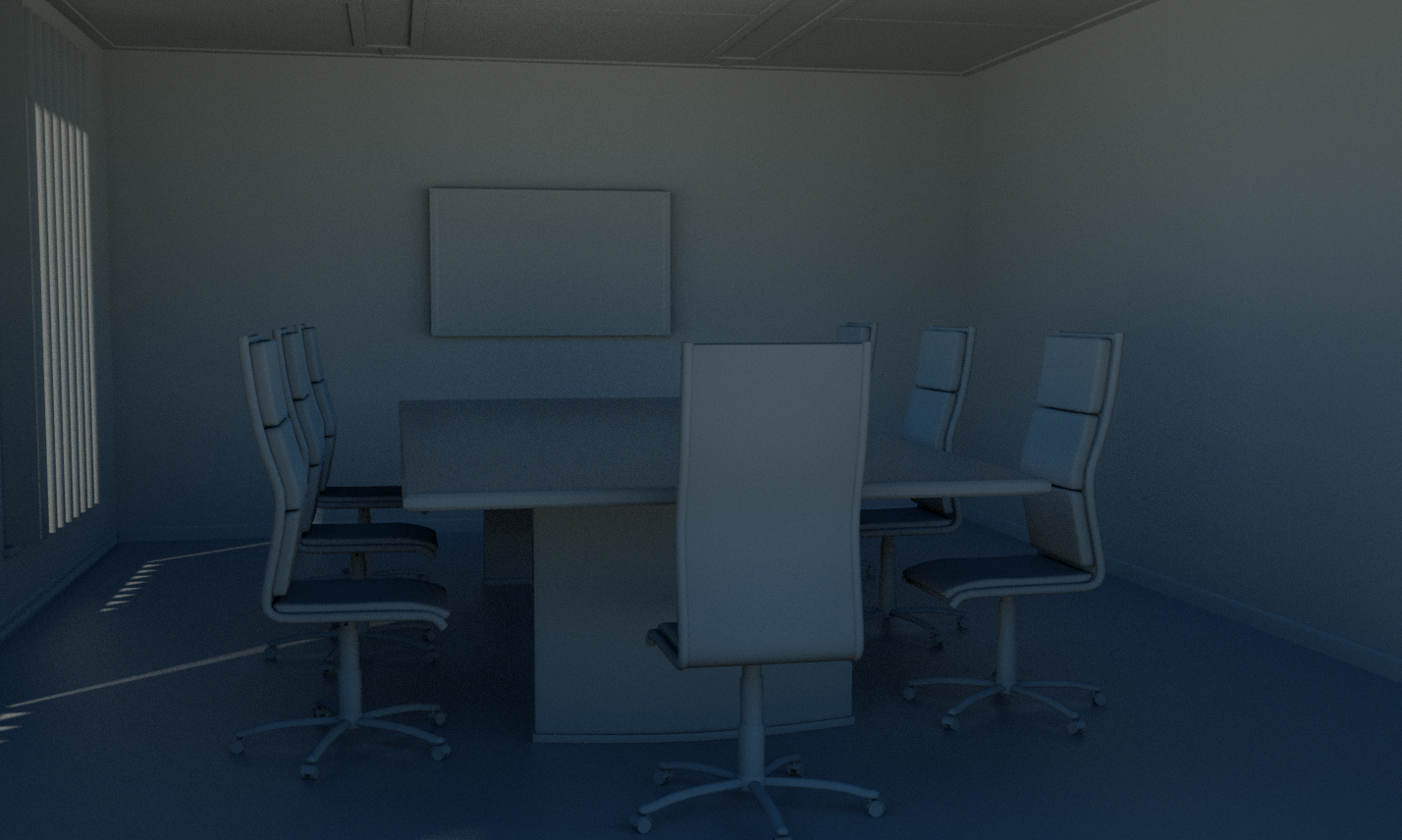

Well I got the recommended driver, latest v3 plugin, did the "replace all active maps." got all the tick marks checked for loading materials from duf. Renders fine the first time I load the scene from the library. but after I save, quit, start program and load scene, all materials are no longer attached and scene renders grey. Very strange.

Can you pls always provide actual version numbers rather than "recommended" or "latest".

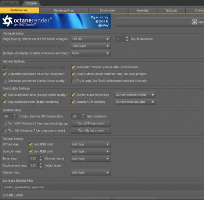

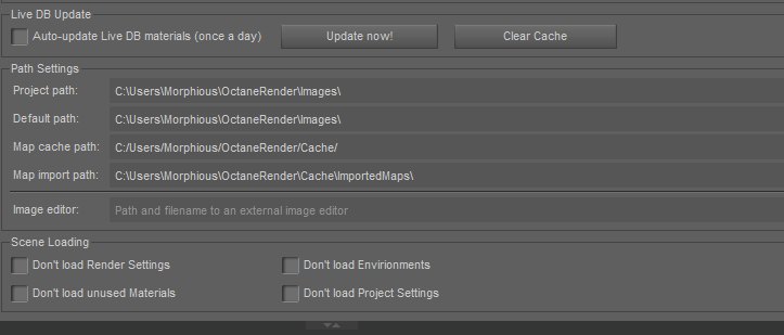

Can you post a screenshot of your Preferences tab and the Materials tab.
Does this happen with all scenes or just one? Does it happen with all figures and props, or just a certain figure or prop?

Nvidia 358.50, Octane 3.0.12.19, As stated before it is only happening with this prop so far. Works in Poser Plugin fine. Same thing happens in Stand Alone. The materials are there, they are just being detached and switched to RGB.

I tried the same prop on work computer. Windows 10, Daz 4.9, Nvidia Driver 365.10, GeForce GTX 980, Quadro K4000, Octane Plugin Demo 2.24.2.4. Works fine. I can close out of Daz, restart Daz, open scene, render in Octane and all materials render fine. Something about my system at home is wacky. Any ideas?

I can confirm this problem being present.
Reloading the materials as auto-materials solves it, but only temporarily until the next scene load.
