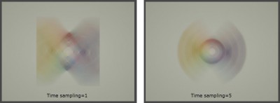

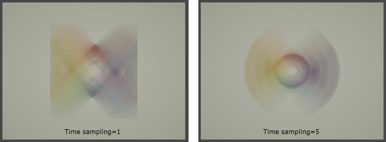

see image. It divides the frames to value and produces more keyframes for renderer. Can you put a scene to show what you mean?

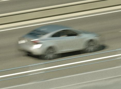

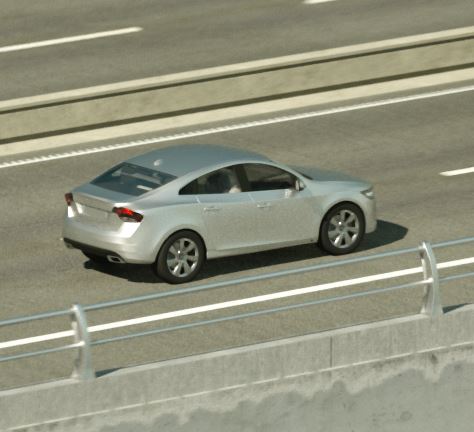

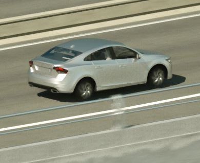

Sure, this is with Time Sampling 1, the wheels are blurred but they shrink
This is with Time Sampling 2 (or more)
The wheels are the right size, but either not blurred, or everything blurs - seems to happen for a few frames, then switch...
