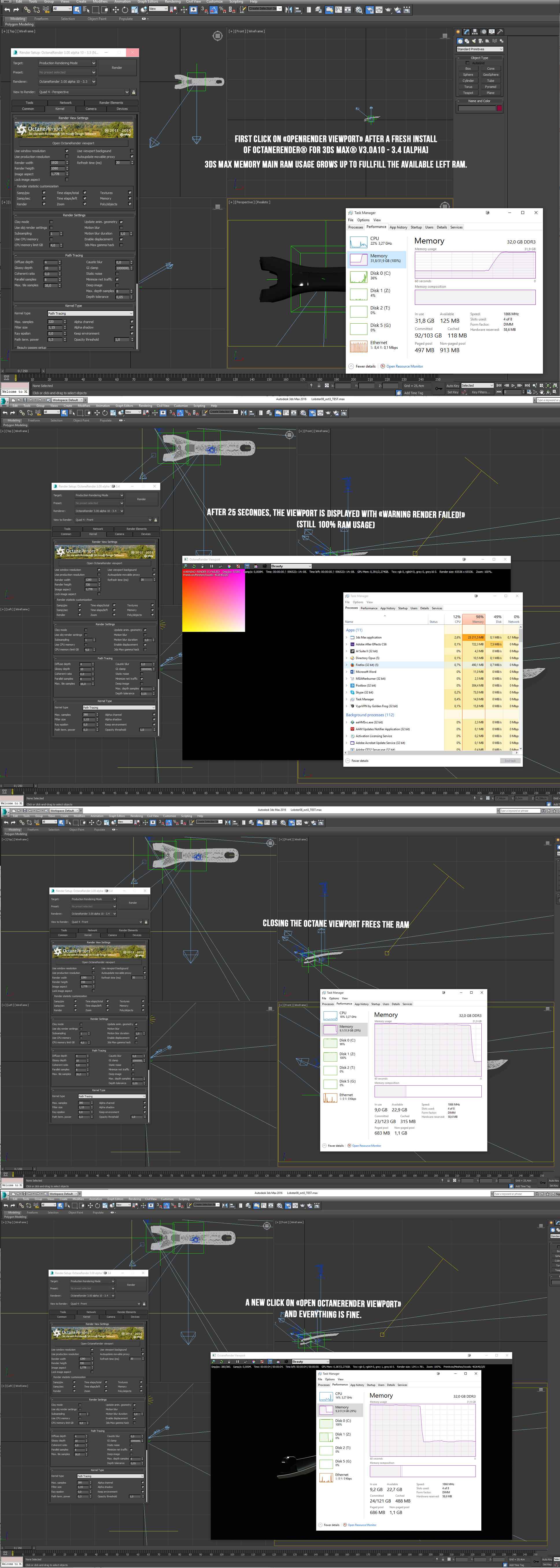

Hi.
Thank you for this new alpha release.
I had the same strange memory behavior than the previous version at the very first start of OctaneRender Viewport , with the memory usage (motherboard RAM).
1. fresh install of the plugin
2. scene load in 3DS Max 2016
3. First click on "open Octanerender viewport"
4. left free Computer RAM is fulfilled by 3DSMAX
5. Octane viewport opens after (around) 25 seconds with "Warning Render Failed !"
6. closing the octane viewport release the used ram.
7. Opening the Octane viewport again works fine with no delay and the render is ok.
I did some screen captures :
Regards.
Carlos Matias
________________________
3ds Max 2016 on windows 10 / Intel Core i7 3930K / RAM 32GB / 1 x 980 Ti / 1 x 780 Ti / nVidia drivers 365.10
JimStar
Posts: 3845
cmatias
Can you give me this scene?
JimStar
Posts: 3845
Thank you!
Your scene triggers some issues in Octane core... The standalone team will look into this.
