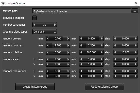

This script creates a number of random image textures, and allows you to use one of these (at random) on each instance of a mesh. It is possible to vary the input image file, and the image transform for each image texture.

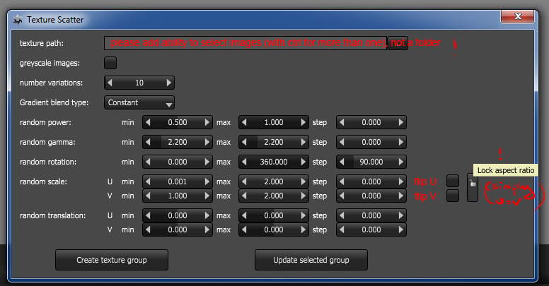

There are some very important features that the script lacks of: selection of a single texture (not a catalogue) and lock for proportions scaling. Plus vertical and horizontal flip (negative scaling) - attached.

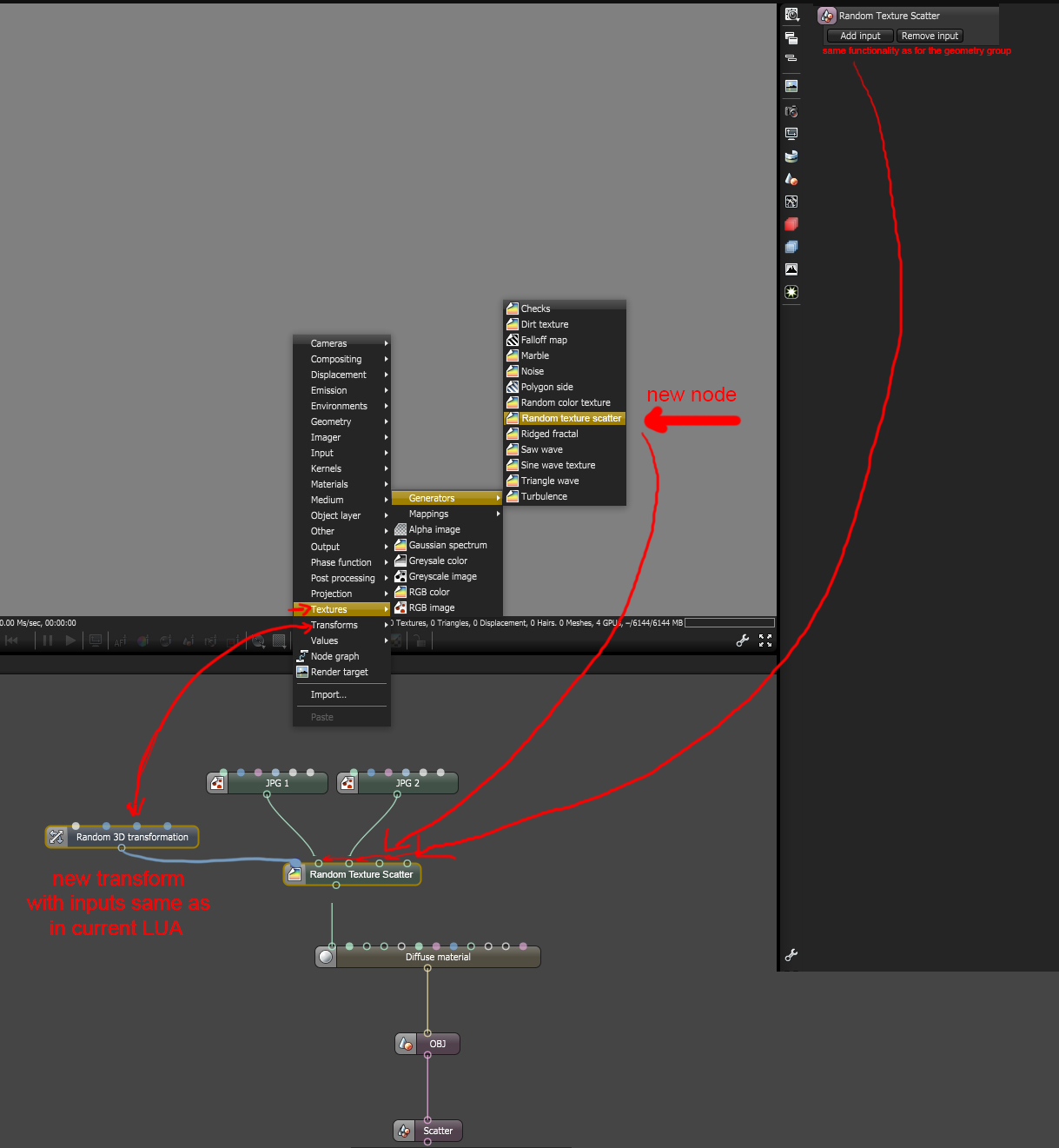

Random texture node that would work in real time is so needed. Namely it could work like this: when you connect it to the texture input it would come with a single input for a texture but with the option to increase number of inputs - exactly the same way that the geometry group works. And another random 3d transform having all parameters from LUA would be great. The schematic is attached.

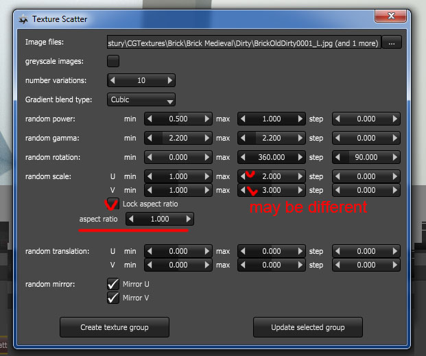

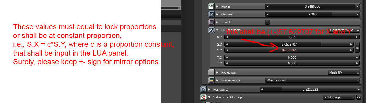

Selecting images instead of folder works like a charm - great! Mirror options work great, but:
1. The most important feature - lock aspect ratio - is not well coded. Sorry, this is my fault - I should give you more explanation. So here it is: it is not about having same values in the input LUA panel, but the same values in the final UV transform for S.X and S.Y. - see the screenshot. So please add aspect ratio option to the input panel, and if a user chooses aspect ratio as 1 we shall see same values in the final UV transform for S.X and S.Y (with +- signs when the mirror is used). So the code for final S.Y may look like S.Y = c*S.X, where c is aspect ratio.
2. A bug: when I open any group in the node graph and run the script the final node occurs in the scene tab, not in the tab where I am currently in. It works only for updating the script. What I have to do is go to the scene tab, cut the node and paste it into a desired tab.
You are the man! It's almost done ;)

roeland
Posts: 1826
OK I should have though that one through I guess.
Update in original post
Roeland

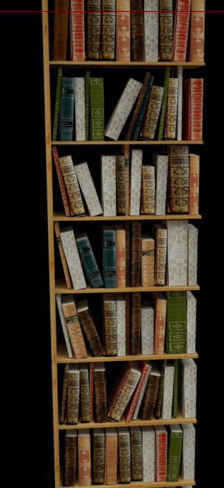

Woooow! you just saved my life, I could not do this with c4d cloned instances and now it's like magic. I just loaded the script applied it to a material and saved the material in local DB, then imported the material in C4d and voilá! I'm saved by your wits!
thumbs up!
cheers!
frankie3333
the texture applied to mograph clones that clone instances.
