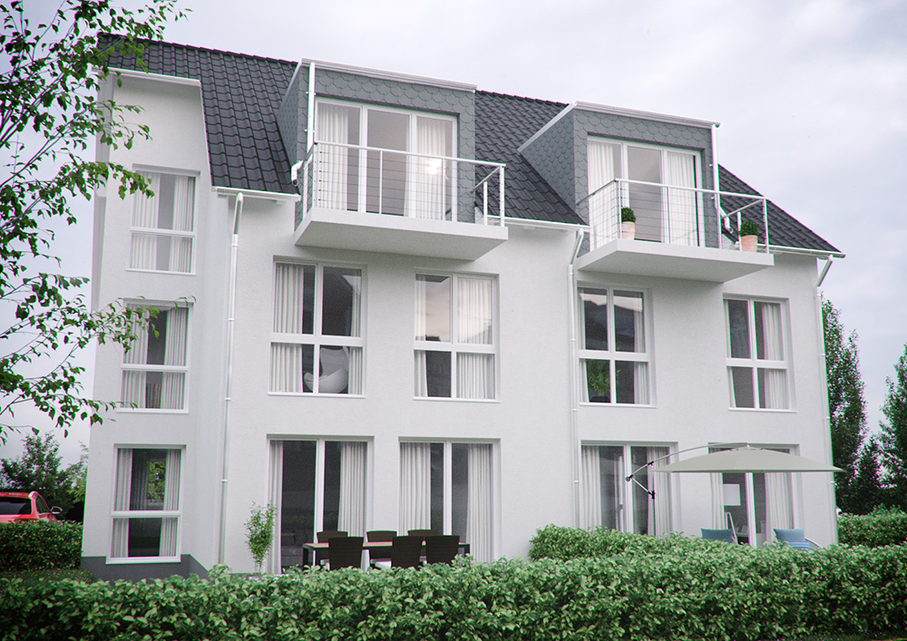

I wonder since months from time to time why Octane don't look realistic to the last bit when it comes to architecture exteriour renderings of residential buildings. At least it looks fairly unrealistic if I do the photo compairson with images on Arch-Daily or so.
It even lacks a bit when I compare to simple exteriours made with Maxwell, VRay or Corona. For each of them you can find great images. It seems Octane misses the final touch, the final light ray to catch all the small imperfections a photo has. On other fields it performs great. Product shots look great
So I startet to test with a recently submitted image to a client of mine. A sunny image, mostly ordered by my clients. I really like the output, client loved it. All good. But as an artist I think it looks to cartoony. If I look out of my window the houses I see look more..."spectral"...and vivid. :lol:
Ususally I use Pathtracing and a HDRI for lighting. Then give it a final touch in Photoshop adding CA, a bit of blur here and there, and some curves plus vignette. Nothing special. Shouldn't it look the same on other Renderers too?
I tried rendering out all elements but I don't like the workflow. I get a long better when I tweak materials in interactive mode and render out one image mostly.
First thing I notice is that Octane renders out better results with cloudy lighting conditions. I don't know why. They just fit. Also images with lots of reflections tend to look more realistic. Like cars in the scene along the building.
I also start to get insecure about using 3D scaned people. They fit in perfect and it is fast but there seems to be wrong something with them. To test it I started to put in 2D people again in my sample which seems to be more "real" for the human eye if they are placed in properly.
I didn't come to a conclusion. Maybe other Renderer offer a more spectral approach. If they are all unbiased why do they not look the same? Is it the physical camera stuff the aboove metioned offer to produce the imperfections of a real lense? Maybe its just me and I do something wrong but I don't know what. I focus on materials and references a lot, I get high-res vegetation for my projects all the time and try to put in some imperfections like the real world. It's not possible everytime when bound to clients and their taste.
Thoughts? Suggestions?

Raw rendering straight out of Octane

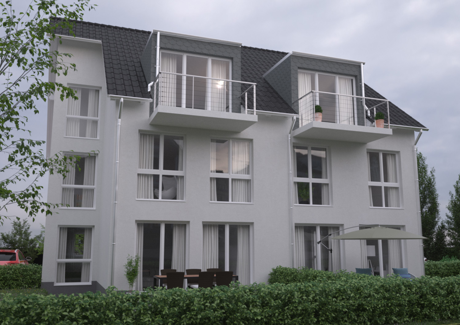

Same with people.
Same with people.

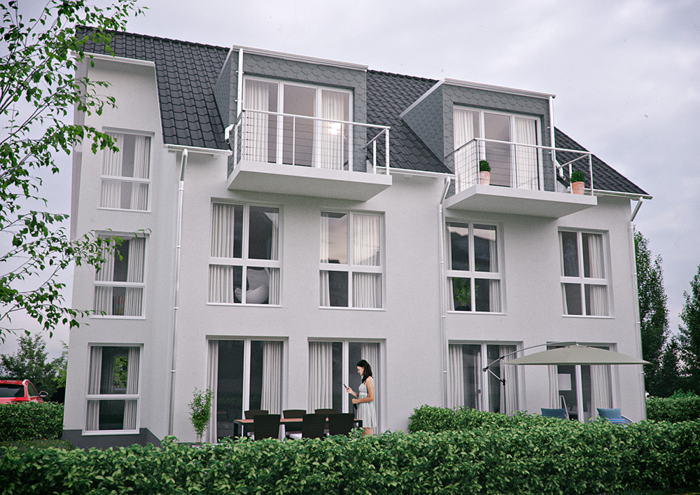

Cloudy version without people.

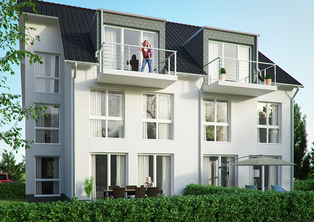

With lots of post and contrast.

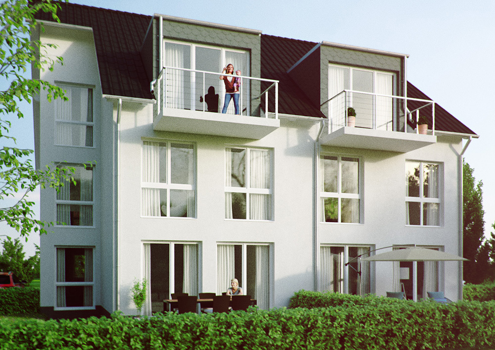

The final image handed to client.

To have a fair comparison and deeper investigation you should render out the same scene and HDRI with Corona too, without post work.

I don't think this has anythign to do with Octane Render itself & to iterate that, let's dig for some random pictures from Facebook group (where a bit mroe movement happening at the momnet =) Here are all of the pieces architecture related.
Other things on people & card. This is a quick workaround for our brains to capture the scale & put the object "house" in right scale..- I like "bussy images" (aka older MIR style), but more than that someOne like Peter Guthrie, Bou\dary keep to impress.
talking about Archdaily & other sites in the same caliber - there's tons of valuable information out there that speaks volumes about composition, architectural photography & even high end photography. Here's one work form PG featured over there. I guess there were very little who from first sight thouh it's a render..
Let's get a bit to c&c part. Overall Your shots are liek 80% & between all what You can see in realestate market those are far from bad (You happy, client happy, that's it =) why to bother, but.. somethign inside say that it's not right. Here's my take:
* perspective. Vertical distortion is rarelly welcome in archphotography (just in some cases). Avoid if possible, but don't forse too much, as Eyes will notice that soemthign is not right.. - this is one of the most important thigns that breaks the illusion & In Your case perspective is not very forgivin'.
* composition..think that always plays a bit.. but for this exact shot You've fired to Your own foot. To close & You make viewer feel uncomfortable..liek forceing him to go too close. A bit more relaxed vied with not so wide angle lense might give better results.
I know that clients do not want or even wish t show too much around, as there might be nothing ..but framind creativelly might help to fill the view without zooming to Your object uncomfortably.
* white balance. &..balance between all colours. Our eyes do not work picking absolute values..but rather relative. If You shift even single colour in image too far, too saturated..again..that breaks entire image. Tasty well balanced light will make even the box on a plane to look real. If You miss that, then try to compensate adding all the details.. You'll get only so far..& hit the same wall.
* CA, & ther imperfections.. why? I mena why to braek all the thigns that Photographers fight & try to achive with simple cheats? You can get no so wide angle lense, place some trees in front & in the back of focus point & use depth of field to give a bit of depth, move viewers attention to focus on important bits (and avoid unesecary details in out of focus areas). Till 3rd7th seems that CA became overused piece..-but hsi strong point was light not all the cheats..
& there are other things along those lines..- long story short, It's a nice work, but You will not make it any better if You focus too much on Render engine, OctaneRender here has nothing to much to do with this. Let's bring some images from OctaneRender..some of them are lightly touched others mainly straight from Octane..few links:
