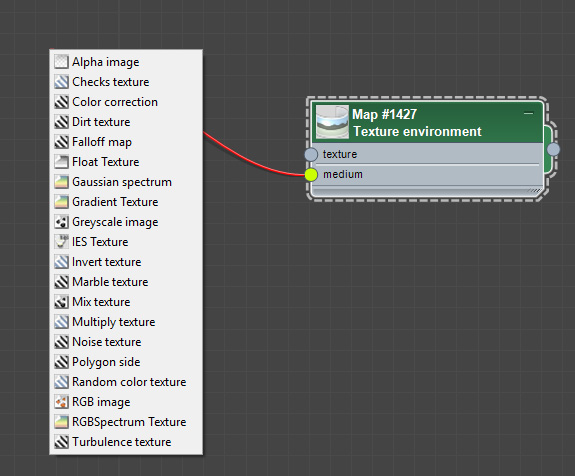

why the scatter medium is not avaiable for the texture enviroinment node?
HHbomb
Posts: 1438
just put your scatter in medium slot of the sun.

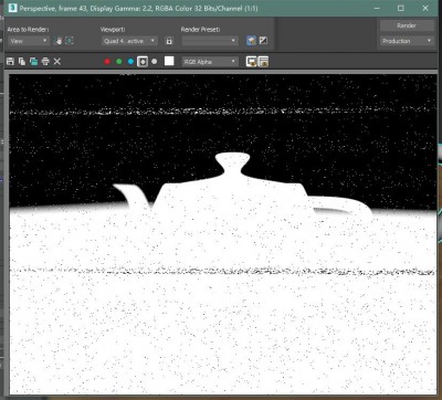

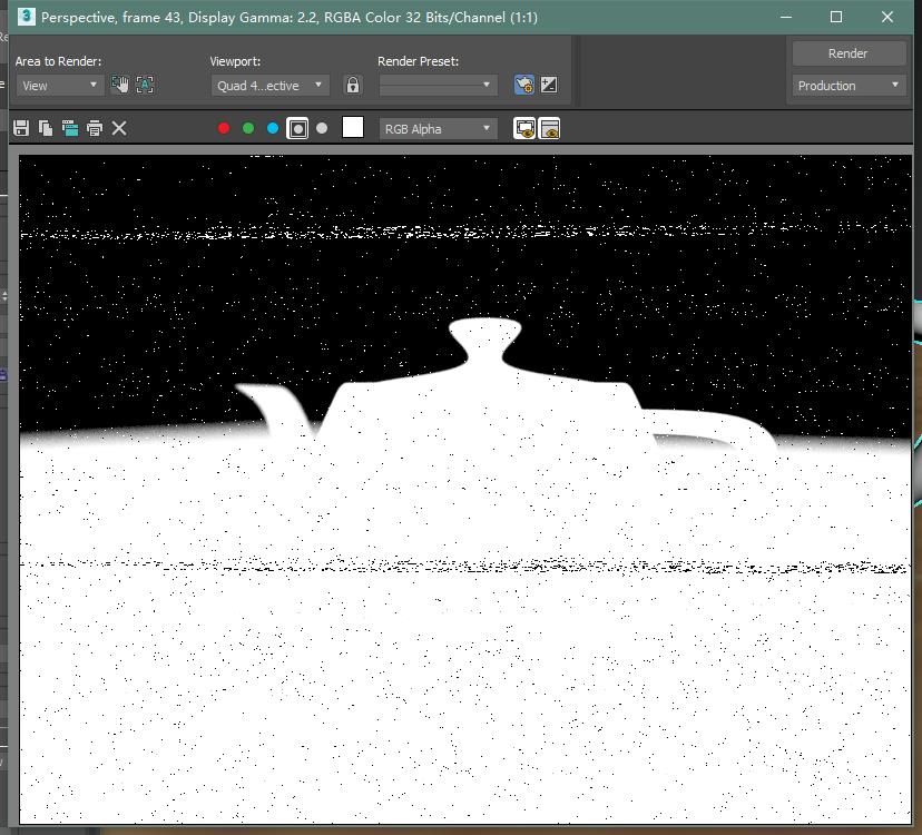

deep channel is working, however when you using the 3ds max native frame buffer to rendering an image, it broke the alpha like a mess! so does the deep image! but in realtime viewport the alpha is woking good!
also could u please add deep output to realtime viewport, currently it has to be saved by using 3ds max frame buffer.. maybe a simple button would be way more better~~ thanks

kevinshane wrote:deep channel is working, however when you using the 3ds max native frame buffer to rendering an image, it broke the alpha like a mess! so does the deep image! but in realtime viewport the alpha is woking good!
Could you give me this scene, so I can look at your settings in there?
kevinshane wrote:also could u please add deep output to realtime viewport, currently it has to be saved by using 3ds max frame buffer.. maybe a simple button would be way more better~~ thanks
Deep image is not supposed to be held neither in 3ds Max frame buffer nor in Octane viewport. It's format is not compatible with them. It is only saved as a complex .exr file into output folder after the rendering of a frame is done.
So, it's some strange on your screenshot. I've never seen this in my test scenes...

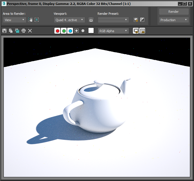

Hi Jim, never mind, I've found the problem of causing this alpha mess, it's because of the 3ds max 2017
I've re-open using 2015 and everything is working fine now except for 3ds max2017, if u shift+Q in 2017 it will get mess alpha, I think it's max bug~
anyway here is the test scene, please try with max2017 and render using max frame buffer, u will get that broken result

I can't reproduce it with your scene in Max 2017 - neither with "Shift+Q" nor with using a "Render" button...
But there is definitely something wrong with 3ds Max 2017 itself (how it uses the GPUs) - 'cause with it running my SnagIt screenshots-tool lags like a crazy, it's almost not possible to use it. There is no such problem with previous 3ds Max versions.
