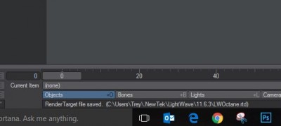

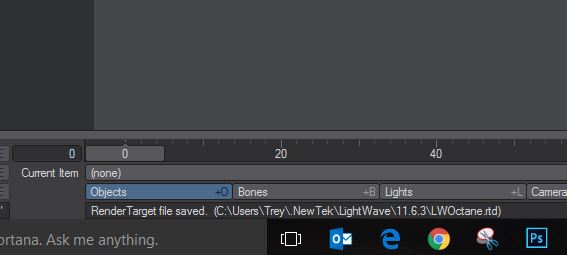

It does seem to save the file in the correct directory. The file is getting updated. Which for me is... C:\Users\Trey\.NewTek\LightWave\11.6.3 Which also answers the other question....I'm using 11.6.3. Will be upgrading to the next version of LW but have not needed anything they've done since then

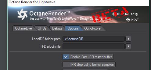

I think I just found it. It is loading from another location. I have a LocalDB folder path set and it is the same directory that Octane is loading from. However when I save DEFAULT it is saving to the Users Directory.
I'm ok with it pulling/savind from/to either..but it needs to be consistent I guess. Can you double check that on your end?

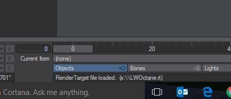

Yes I noticed when Ioaded up lightwave and activated octane it showed that it loaded from my x:\ directory which is set as my LocalDB path. I could only guess that was where it got the path, was from the options inside Octane. It could also be that my CONTENT directory is set there as well. But I figured it was from the options panel in Octane.

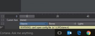

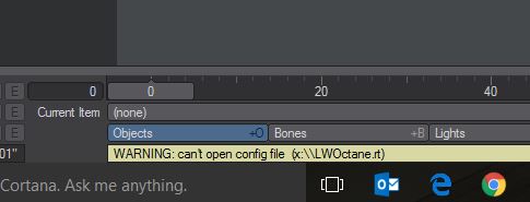

EDIT: After doing some tests. You can see below the different status updates I get. If I delete the .rt file (not rtd) in X:\ which is where my LocalDB path is set in options, I get an ERROR, HOWEVER Octane THEN loads the .rtd file stored in the USERS directory. So there must be something somewhere saying if path set pull from there...or something. Hope that helps find it. I think the current workaround is just delete the .rt file in the other location and Octane is back to normal. It might be that as versions have changed this is a file remnant and some code remnant. *shurg* But this workaround still gives an error message even though it loads correct file.
