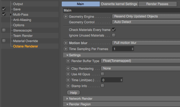

Hi guys i am sure i am doing something wrong so can any one please help ok i need motion blur pass so i can do motion blur later in after effect.

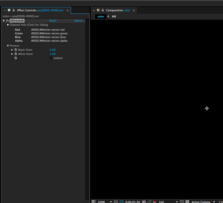

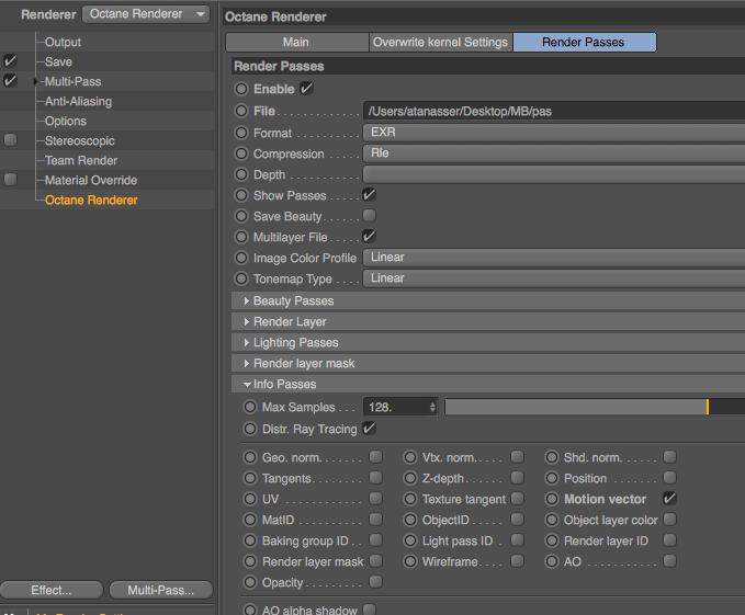

motion blur work with me fine in live window and picture viewer any soon i enable motion vector pass the motion blur despair live window and picture viewer this good for me because i want render without MB so i can add it later in post the problem is i get black screen in the render motion vector pass.
please find the attach image and the c4d file.

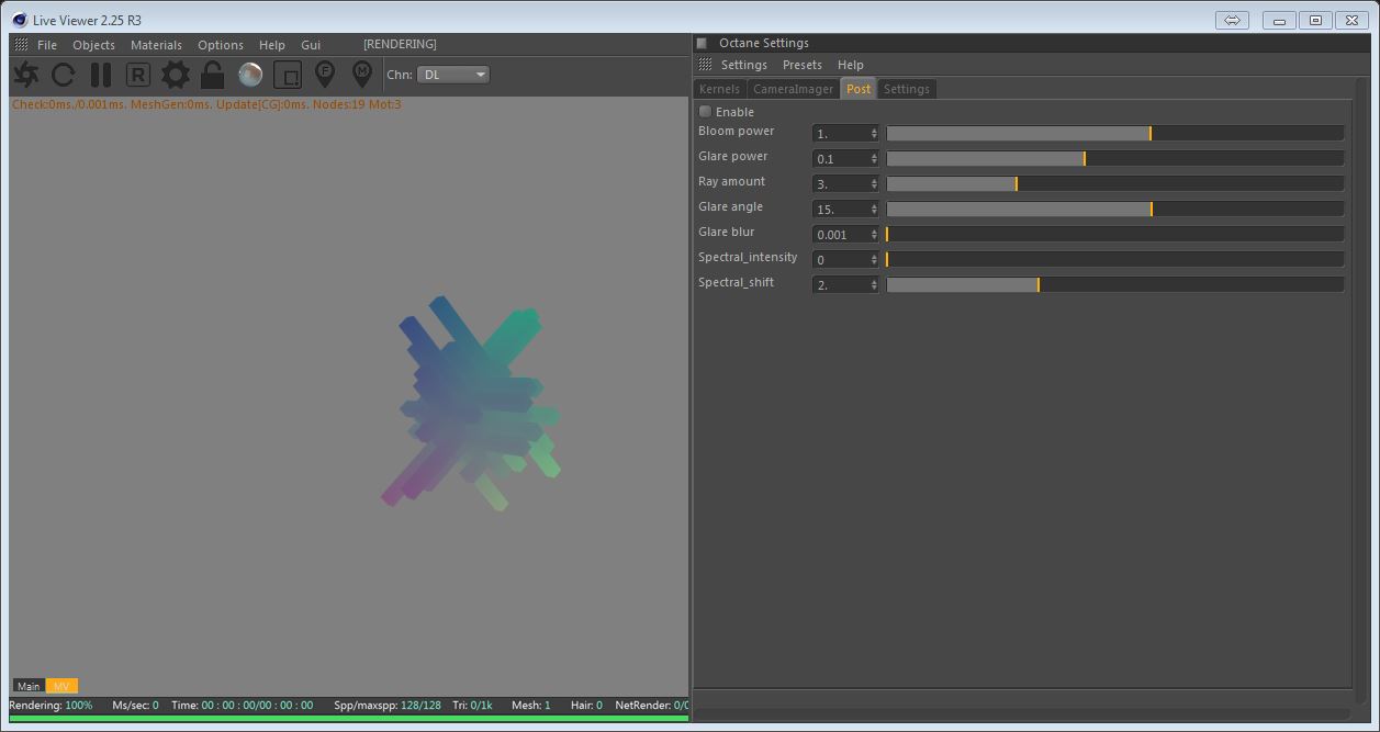

Hi albehany,
I guess that there is an issue with v3 alpha 6.3 and motion vector pass
Please, could you try with v2.25 R3 instead, or export in orbx to standalone and correct the shutter intervall value? *note, I have exagerated the max speed value in the info pass preferences to better see the effect
ciao beppe
ciao beppe
Yes this working thank you so much
