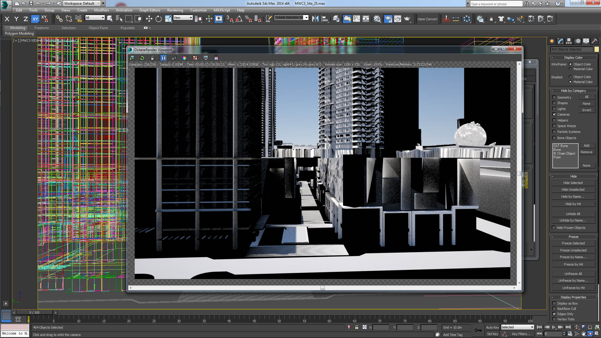

Ok all,
So we've been using version 2.16a for over a year now with minimal issues.
As of lately this crazy-looking error has been happening to many of our files. In the past, we would just get a *WARNING Render Failed* error message. Now, there is no message, just these black frames.
Any ideas what is causing it?
If you look at the info on top, we are well within our limits of geometry, textures and vram. It is happening more and more frequently on 4 of our current projects.
And of course, our deadlines are ALL due every week between now and May 20. Serious deadlines for serious clients.
Any help or advice would be greatly, GREATLY appreciated!

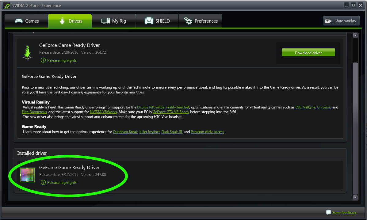

The first thing we usually check is driver versions - please confirm what driver versions you are using. In the case of network rendering (if you are using this approach to rendering, of course), it is important to confirm that your driver versions are the same on both the master and slave machines to assure stable functionality.
If this is not the issue, then it is possibly a hardware issue - you may need to test your GPUs to confirm whether one or more have become faulty.
If you are encountering these issues on scenes that have worked correctly in the past but are failing now (on the same machines with the same SA and plugin version), then faulty hardware or driver issues are the most probable by far. If this is not the case, we will expand our troubleshooting from there

1/ Ok, we are using driver 347.88. It's older, but it has been working for us so far. All of our machines (stations and render slaves) use this same driver. We are still on Windows 7.

Maybe some problems with import from Sketchup...
Or you may have hit the ceiling of total amount of Octane nodes...
To check it: try to remove a half of the materials and textures and see if the "black weirdness" disappear...

My preferred way is to select the objects you want to remove materials from, open the MAXScript listener (F11), and use this line: $.material=undefined
That will remove the material from any selected objects (it will do nothing if no objects are selected. Hope this helps
