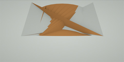

I'm just testing with the simple box scene I sent you. It still exports the box flipped.
EDIT: I have attached the scene along with the exported data so you can see it
Edit2: OK I just noticed you posted an update for the update ;) Ill try this newer one out

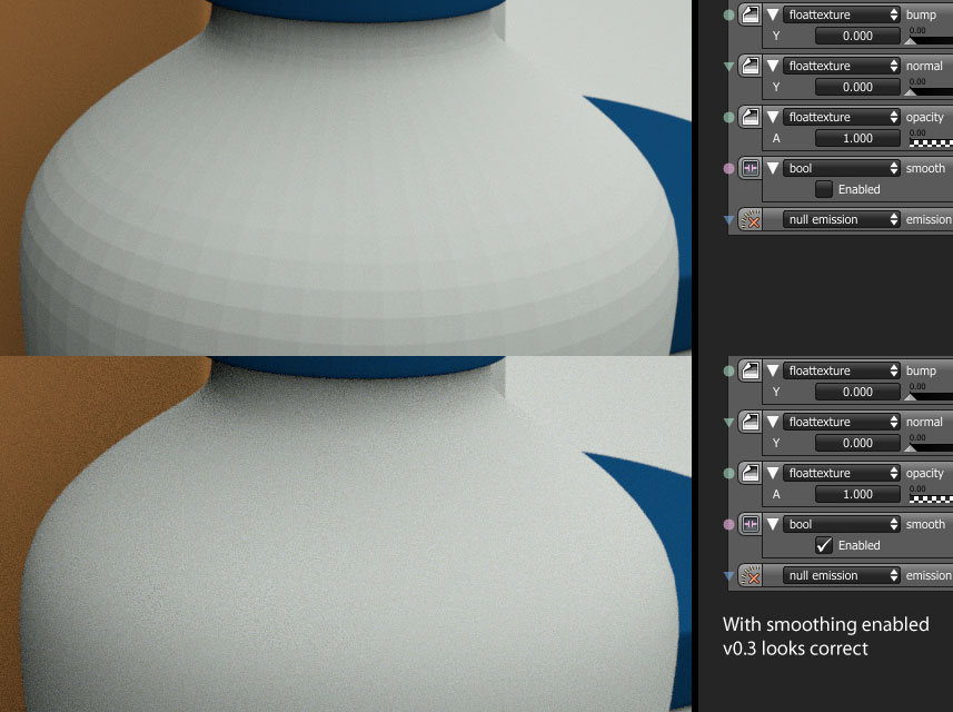

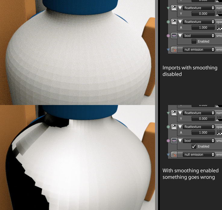

When I import objects and enable smoothing, the smoothing/vertex normals are wrong. This didnt happen in 0.3
I'm just guessing here... when you fixed the polygon flipping, you saved them in a new order and now the vertex normals need to be saved in the new order.

I went back to v0.3 to test and it works correct with smoothing, so this is a new bug in 0.4

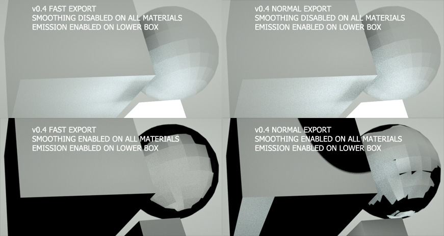

and if you try "normal" instead of "fast"?

If I use "normal" instead of "fast" all the vertices get messed up. This happened in 0.3 too, so I used fast instead which works almost perfectly

I tried testing with a simpler scene so "normal" export could export it. There is still the same issue when smoothing is enabled. Also note when smoothing is enabled on with emission, the emitter doesnt appear bright white even though light emits from it
I have included the scene as well as the exported files so you can view them
