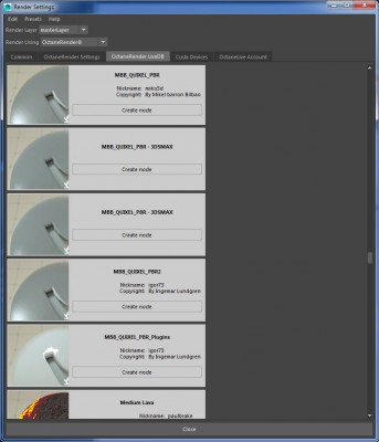

Hello, sorry if this has been asked before.
Is there a PBR Shader for Octane in Maya?
Quixel in particular.
I've noticed there are a few
MBB_QUIXEL ... in the Live DB list but I couldn't make them work.
Any ideas?

I had the same problem. When you import from Live DB directly to Maya it won't work. So I decided to transcript manually the nodes from standalone to Maya. My guess is the network get broken because of a missing feature in the Gradient octane node for maya. In the standalone you can input textures in the gradient points, In Maya only RGB color input.
Now I realize and regret buying Maya plugin, they are very behind C4D plugin development stage.
So I tried to fix that replacing this gradient shader with a mix material and a Fallout map. I think it worked like in Standalone. Even in standalone I had some problem with a Aluminum Quixel material appearing dark. But my project was really simple so I don't really know if other differences might occur.
I didn't try to fully understand what's happening on this shader network, but for me, sounds it should be much simpler. I hope the developers help us with that. Quixel is a much powerful tool than relying on Octane Live DB for creating materials.
