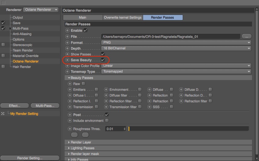

Hi shoqman,
have you ticked the "Save beauty" option in the Render Passes tab?

Yes, both the beauty pass and the RGBA pass that Cinema saves now have the post FX baked into the render.

you are right but I guess it is not plugin related, there is an issue in the SDK.
I'm going to inform the devs about this issue.
For now, as a workaround, save your rendering with the Post effect disabled, then made a second one of just few sampling just for the Post effect pass ;)
