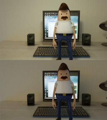

After the first frame is rendered the lights go out. Only the light from the environment remains. I had the same problem a long time ago and thought there was a fix for this but I cant find it anywhere in the forum.

Was this ever solved? if so I'd like to know the answer too.
I've only experienced this when the light's transform is not set to global.

Yes it seems this kind of issue with Octane light is gone in the V3 plugin.QuinceHungaryKft wrote:Was this ever solved? if so I'd like to know the answer too.
Not sure if this was relative to geometry type badly handled or wrong scene scale applied to light but this have been fixed in the plugin in general I think.
