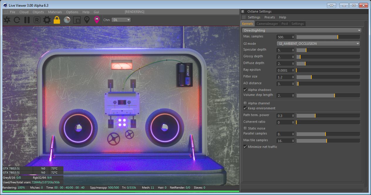

Hi adeel 93,
I have revisited your light setup for the tape and now it cleans much faster:
Music Box_b.7z
(718.47 KiB) Downloaded 318 times
Basically, avoid to have recessed emissive polygons and avoid also emitters inside specular materials.
It's a good practice to use the gaussian node with texture emissions and you can use the emissive node inside the scattering medium node for lighting up the specular material ;)

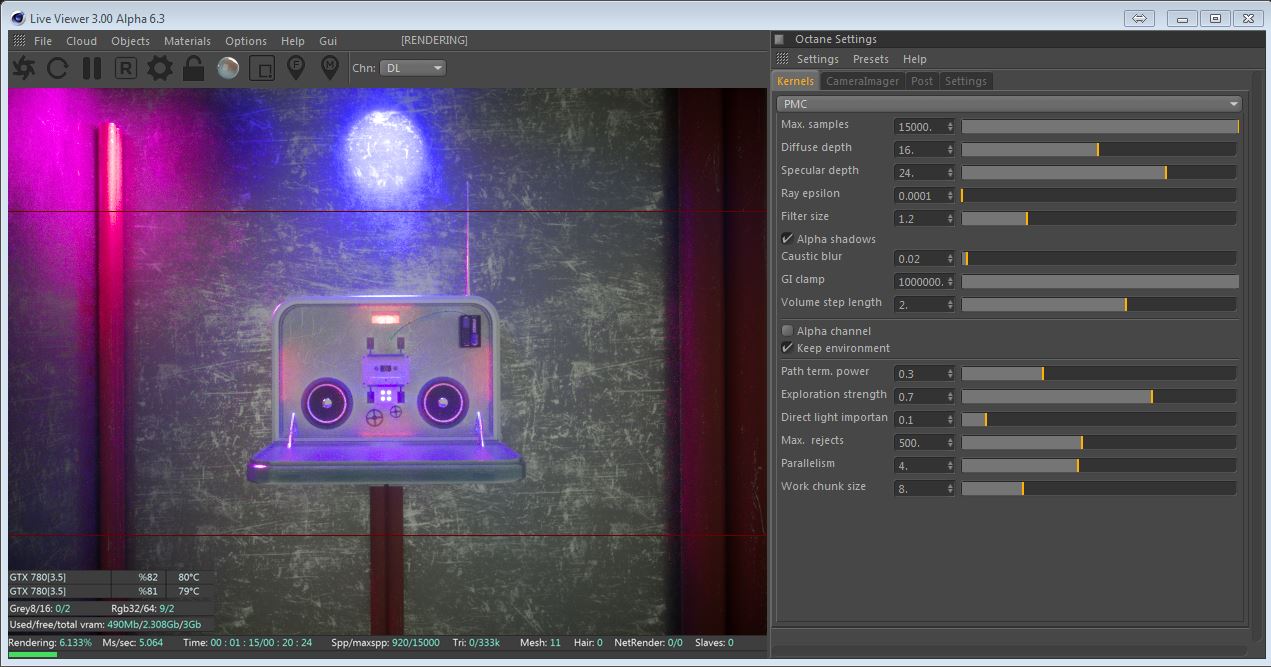

Now the render has gone a little funny when put on PMC.
Windows 10 / 16GB Ram / GTX 980 Ti SLI / Cinema 4D R16
