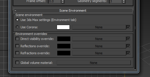

Using Corona environment overrides as an example :- Cheers!

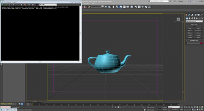

Start: This scene has one object, and no lighting

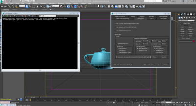

Step 1: Press Alt + B to bring up the Viewport Configuration window. Click the "Background" tab. Choose "Use Files:", then click "Files..." and select you background image.

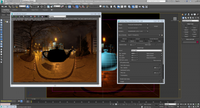

Step 3: Bring your Environment Map into the scene. Open "Environment and Effects" and drag the Map into the Environment Map
Final Result:
