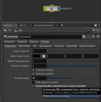

How can I render particles with motion blur? when I turn on instance motion blur in the render node, it tells me to add octane obj spare parameters to the instance node, but they dont appear when I click the corresponding button. Only on non-instance geometry nodes. Is this a bug?
If you have problems related to the instancing motion blur, probably the problem is that the instancer doesn't have the same number of particles among the frames. In this case the motion blur must be computed from the velocity vector attribute, that must be enabled adding the OBJ spare parameters to the instancer node. You have this option in the properties tab.s---70 wrote:How can I render particles with motion blur? when I turn on instance motion blur in the render node, it tells me to add octane obj spare parameters to the instance node, but they dont appear when I click the corresponding button. Only on non-instance geometry nodes. Is this a bug?
-Juanjo
Weird, so are you saying that you have a Instance OBJ node and you can't add the Octane spare parameters to it? The 3.00.20.0 is the latest build, so this is not the problem.s---70 wrote:the problem is, that it doesnt let me add the octane parameters to instancer nodes. works with other geometry nodes but not the instancer node.
Version is 3.00.20, maybe I have to update.
