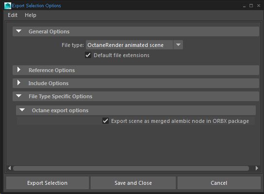

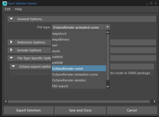

calus
Posts: 1308
Location: Paris
If you don't have this option to export from maya, there must be something wrong with your plugin, it's here since 7.19 version of the plugin.
"OctaneRender scene" option, export the scene as .obj embeded in the .orbx file.
"OctaneRender animated scene" option, export the scene as an alembic file embeded in the .orbx file.
These two options works really well now, just export with the first option for still frame or the second one for animations and cameras, and just select the render target(2) in standalone to render your scene out of the box.
I didn't use the third option "Octanerender Alembic" since a long time now, but it might still be useful to update the geometry of orbx exported with the "OctaneRender animated scene" option ... checking this now (and also the visibilty issues you had with this "Octanerender Alembic").
