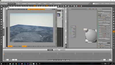

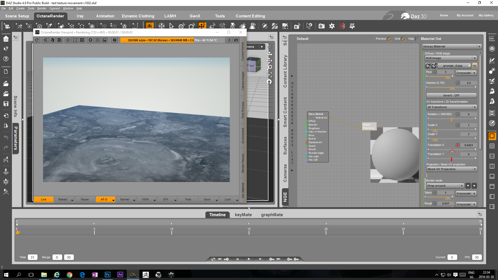

While doing a quick animation test of a x translated plane texture

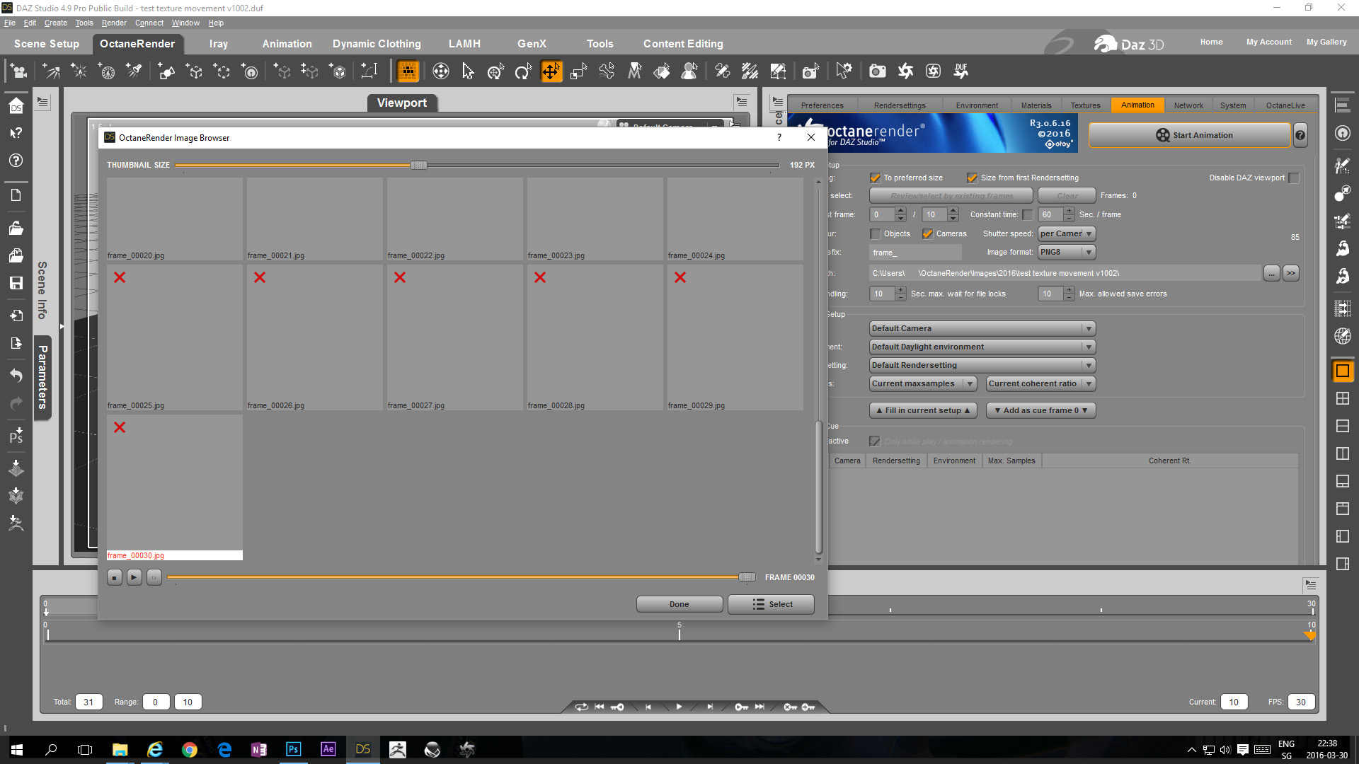

I noticed that after all frames of the animation had finished rendering
- the preview frames in the OctaneRender Image browser (ORIB) all showed a red X with the error message "File not found" when hovering over the frame
-> The preview thumbnail image of the rendered frame is not showing (anymore).

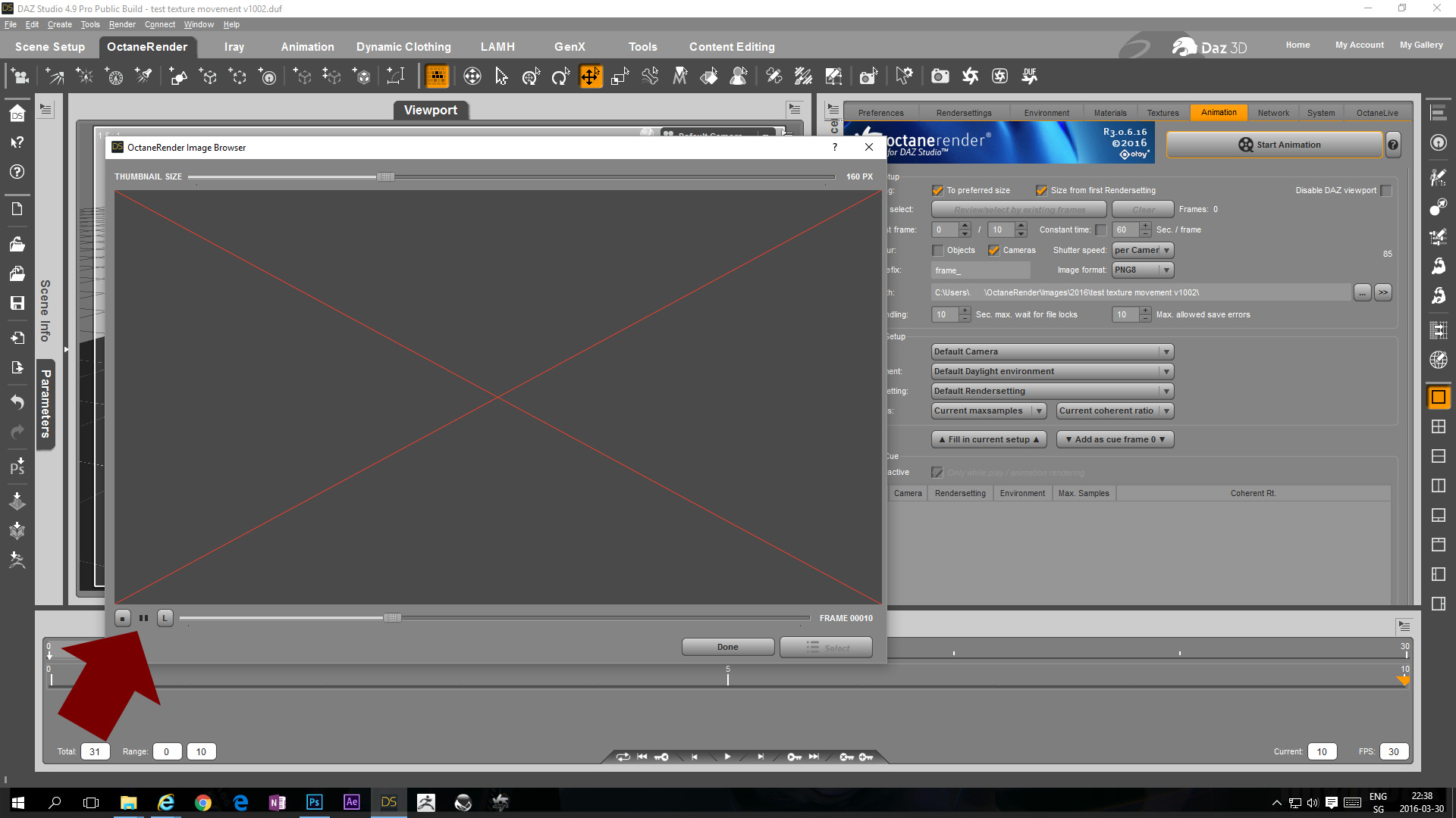

- the animation does not play back when clicking on the "play button" in the ORIB
- the selected frames number in the OcDS animation tab and the frames number in ORIB do not match
example: 10 frames rendered but 30 frames as thumbnail preview in ORIB with red x and message "File not found"

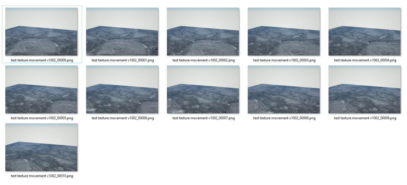

- nevertheless the 10 frames are showing up in the target save folder that was indicated in the OcDS animation tab

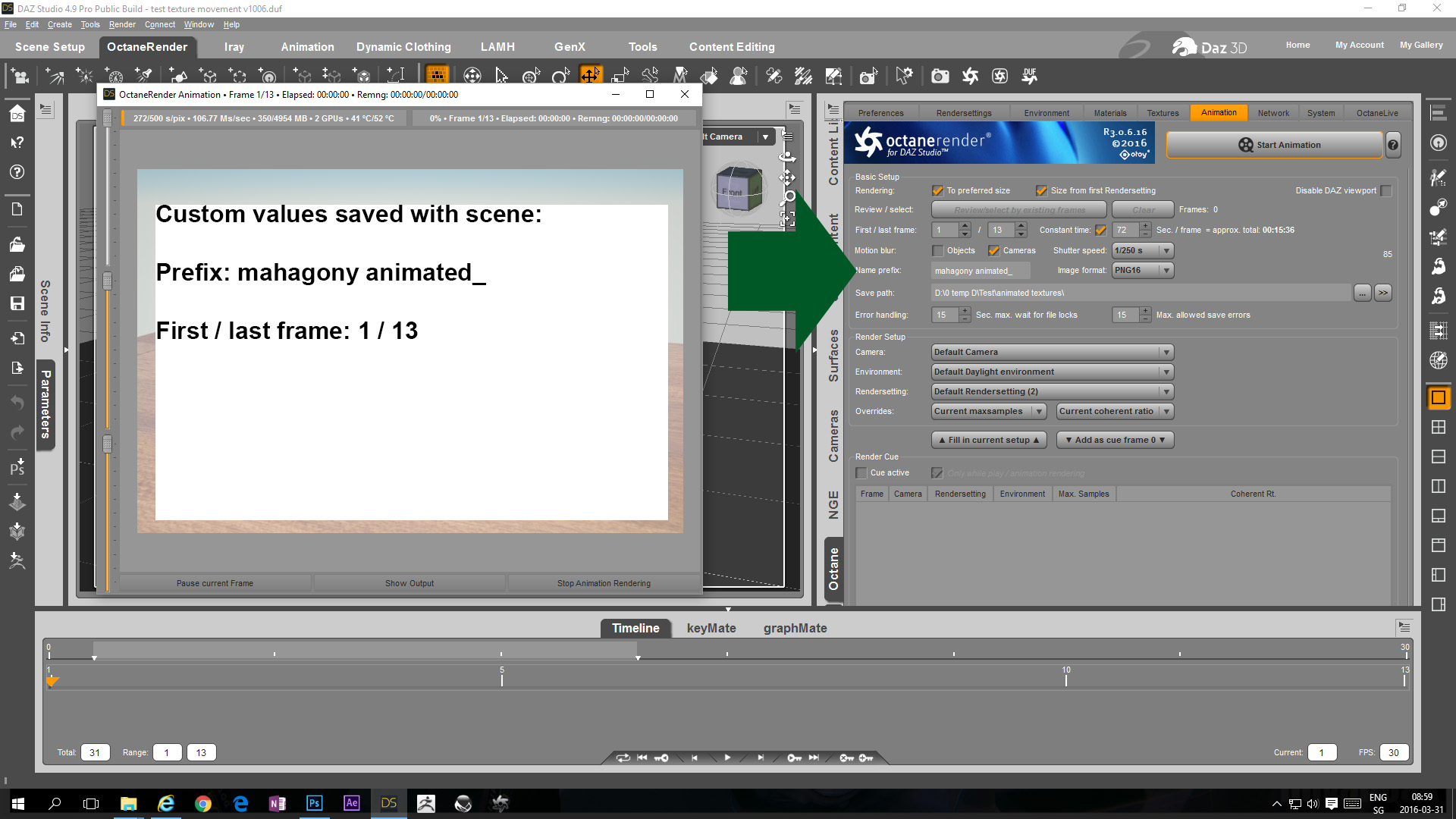

Test values changed before saving scene:
- Prefix changed to: mahagony animated_
- first / last frame: 1 / 13

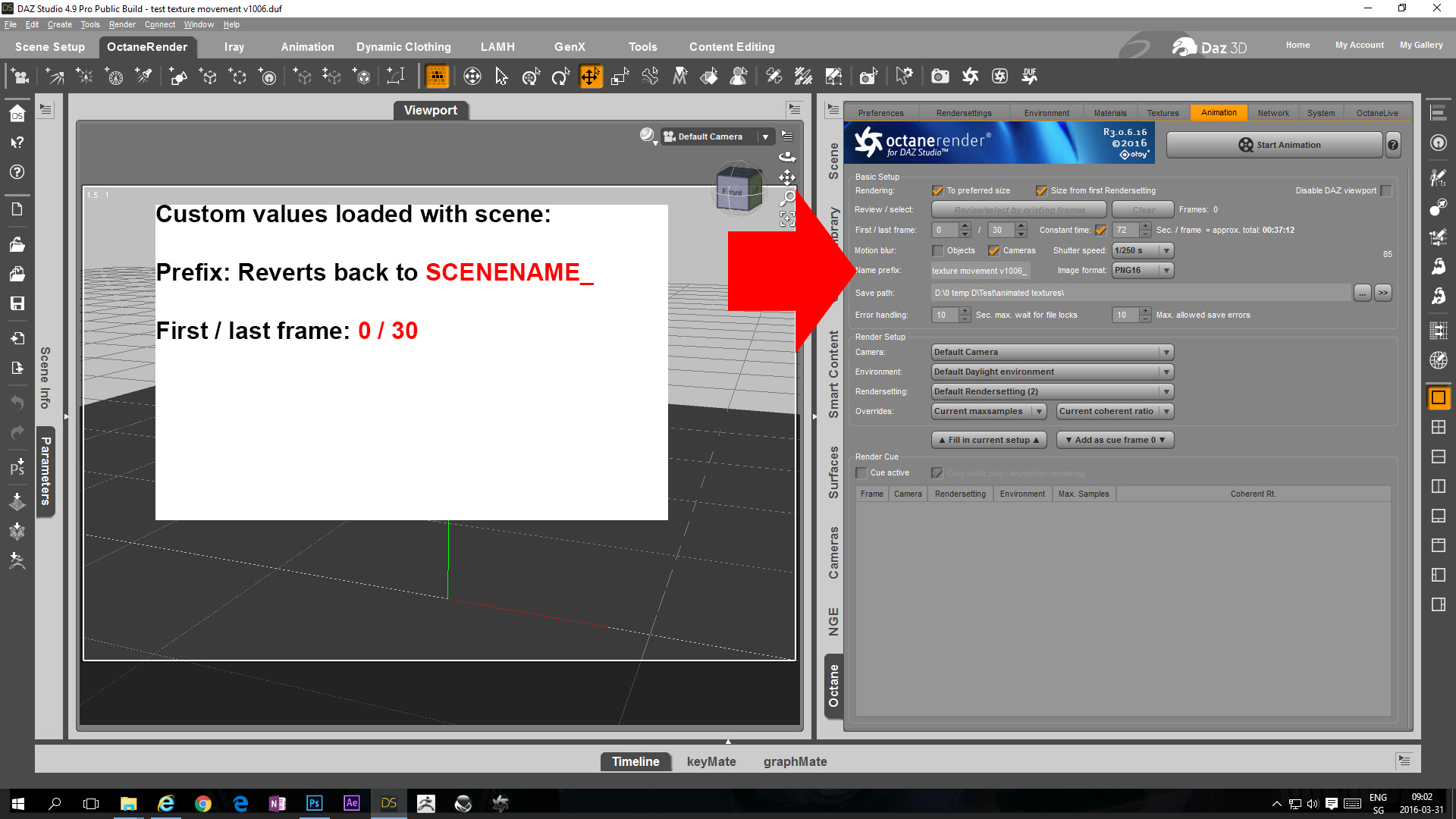

Values after closing and restarting DS and scene load:
- Prefix changed to: SCENENAME_
- first / last frame: 0 / 30
-> The name of the prefix is automatically changed to the name of the loaded scene even when a custom name was set for the prefix.
-> first / last frame reset back to the default 0 / 30 values after scene load
- The error handling values of 15 seconds were also reset to 10 seconds.
- Other values like, constant time selected, file type etc. seemed to stick with the saved values after scene reload.

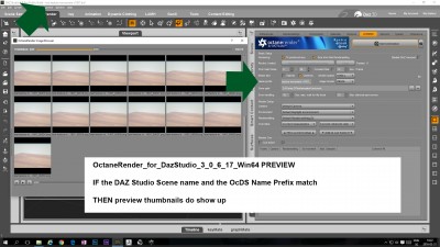

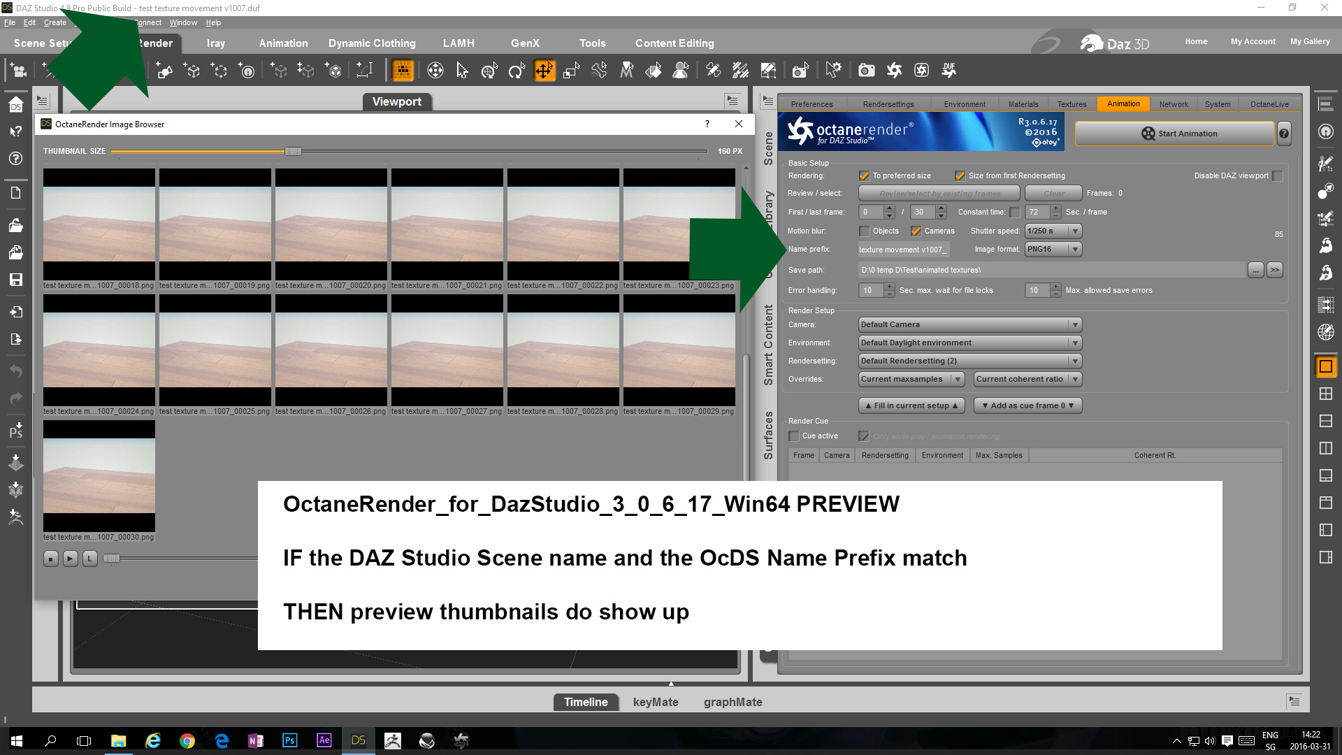

In the meantime a partial workaround for the OctaneRender_for_DazStudio_3_0_6_17_Win64 PREVIEW posted here:
viewtopic.php?f=44&t=52846#p268795
The preview thumbnails do show up
IF the DAZ Studio Scene name and the OcDS Name Prefix match

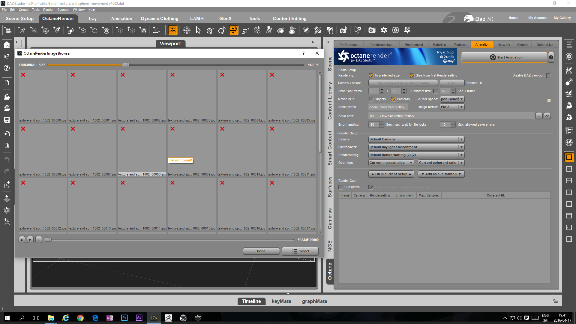

1) if the prefix and the scene name match -> preview images do now also not show up in the ORIB ( this workaround was still working in the 3_0_6_17 PREVIEW version)
2) if prefix and scene name do not match -> no preview images show up
