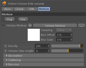

Yambo wrote:Just load it via the Volume fog object.
Then play with import unit, medium density, and reduce the volume step length in the kernel settings.
I have downloaded the latest Beta version and do not see an option to adjust "Volume Step Length"...
Has this feature been renamed or moved?
Thanks in advance.
haze
Posts: 1003
Joined: Sun Feb 08, 2015 8:57 pm
We've moved the volume step length to the volume node, so that you can have different step lengths for different volumes :)
calus
Posts: 1308
Location: Paris
In the medium tab, unfold the Volume Medium Node to see it.
