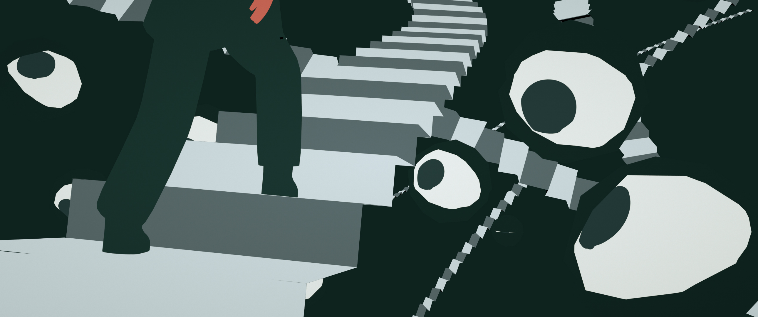

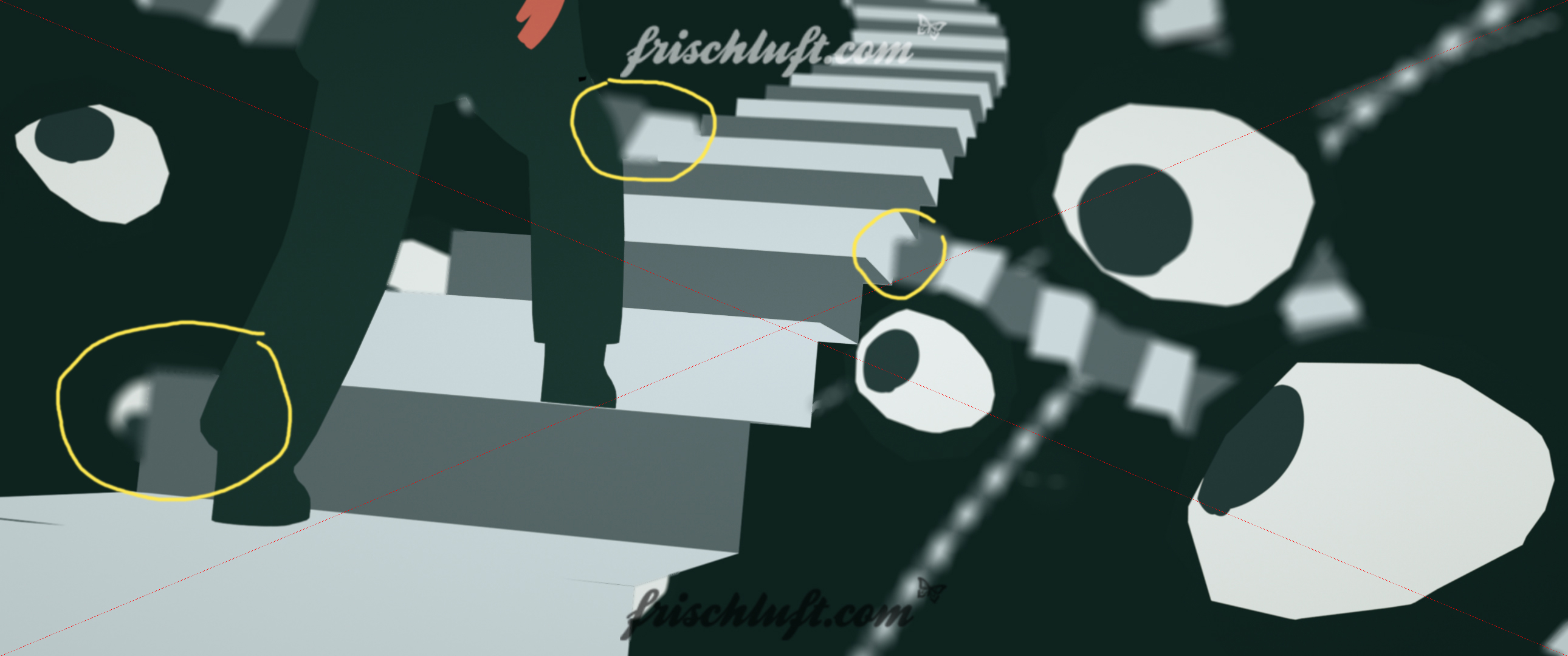

I have met some problem with Z-depth.

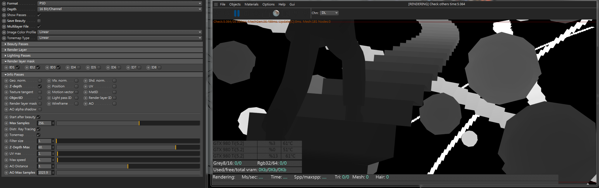

I attempt to make 2D style in Octane (Texture Emission shader). I render both Beauty and Z-depth, then composite in AE with Frischluft DOF.
But I get some wired edges or strange blur.
Have any idea?
Thanks for your time.

weird, from what I can see, the z-pass image seems correct in those points :roll:
have you tried in 32 bit mode or as separate file to see if it helps?
