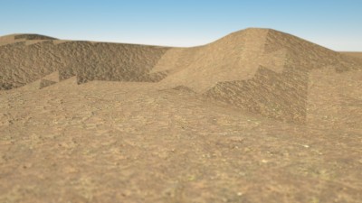

Does anyone know why I am getting jagged shading when I apply my normal. I don't get this problem when using my normal in Lightwave's renderer or Marmoset.

Try tweaking Ray Epsilon in render target.

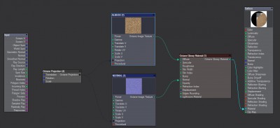

Thanks for your reply. I figure out what it is was, I had the UV projection set to box so it projecting from the sides once the angle went over a certain amount. Thanks for trying to help though :)
