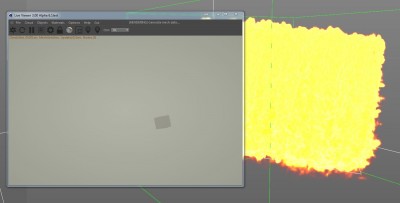

Hello,
Turbulence FD 1404 - C4d R16.050 - Octane 3 Alpha 6
I do have a bug with one of my scene
The render is flat
https://www.dropbox.com/s/1shgpd4klzq35 ... e.c4d?dl=1
Do you guys have the same?

Yeah sorry,
I had no problem at all when i put the TFD setup at x=0 y=0 z=0 as u can see overhere
http://vimeo.com/160233831

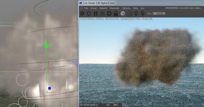

When i copy/past the turbulence FD container from my test scene to my main scene and place/rescale / or place/and reajust container size it to my main scene. this is what happen on the 2nd screenshot.
So i tried an other way by recreating a new turbulence FD container and matched my values for the scène and same thing happened
Then i tried to copy past the buggy one to my test scene and the same thing happen.
I tend to say, this is maybe about scale but i'm not sure.

I 've got nothing
Screen from the file i added post #1
Screen from my main scene where i want to use

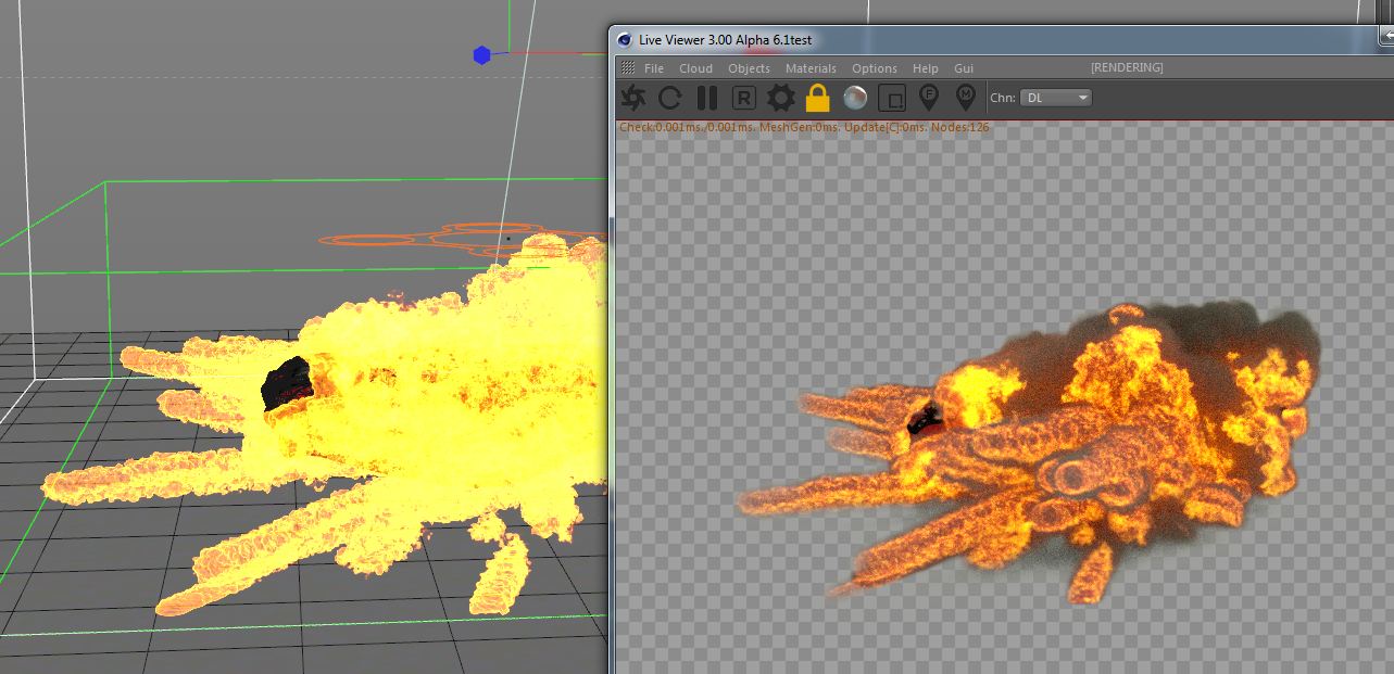

octane_bug_0.JPG/attachment] Screen from my setup scene before to go to my main scene (ok) [attachment=3]bug_octane_3.JPG.
Screen from an other scene i am working with (ok)
[attachment=3]pluging_ok.JPG/attachment]
