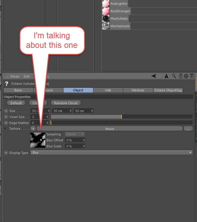

Is it possible in some way to animate the "build in" noise inside the Volume object? Becouse i cant get this done, this is just not responding no matter what i'm doing.
Is it lack of functionality? If it will be possible it will be super useful to create some clouds movement.
Thanks.

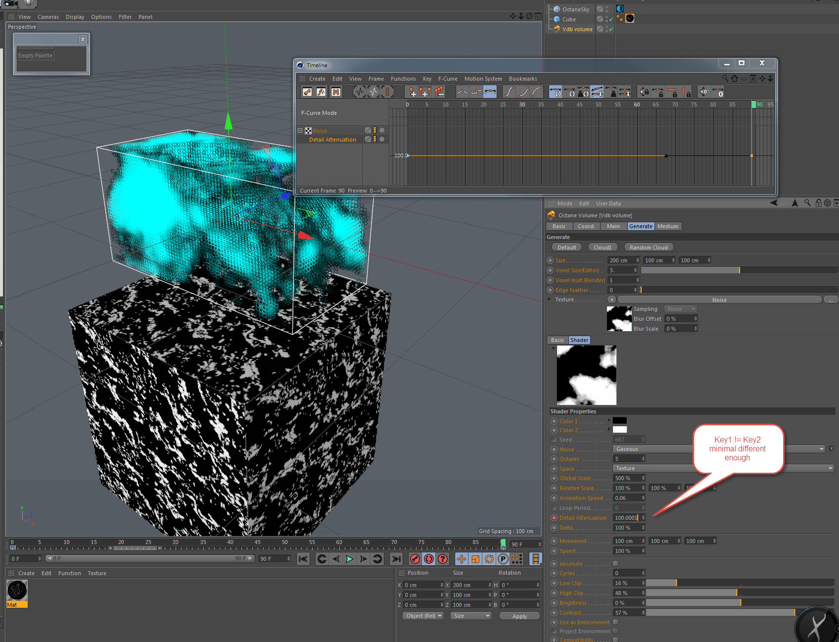

Just setting a keyframe at same value is not enough. Key values should be different. See picture.

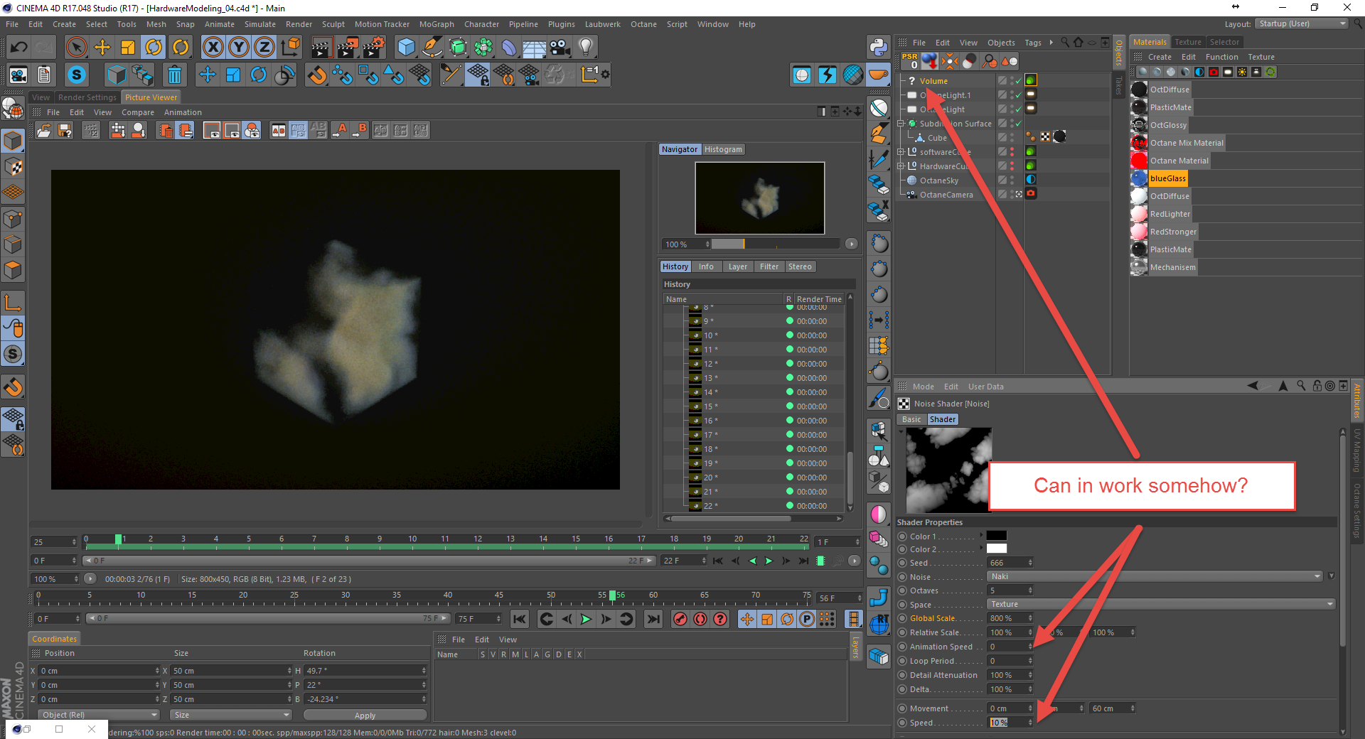

Ok, I think I need to be clearer - "Movement" and "Speed" attributes in noise are not translated into rendering.
Here is an updated file (added small change in keyframes):
oct3_noise_02.zip
(205.8 KiB) Downloaded 249 times
Here is the rendered result, left c4d, right octane:
oct3_noise_c4d.mp4
(353.2 KiB) Downloaded 4606 times
If this is supported I am clearly doing something wrong, please let me know what it is, thanks.
