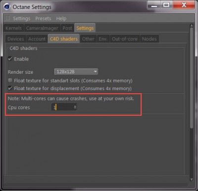

I see you are using C4D shaders in Octane materials. Propably layer type. And you might have multi-core activated for "Render C4D Shader" functions. Cpu cores=1 mean single thread, n>1 mean multi.
So please don't do this for complex C4D shaders!!! As you can read in settings i don't advice that and I wrote that as an warning.
So that's a known problem with multi-processing of complex C4D shaders rather than bug.

Thank you aoktar. I ended up doing a windows restore and the problem was resolved. Now I know not to mess with that setting, I don't even remember turning it on.

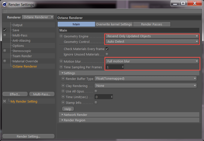

I did have one other issue with geometry and motion blur not working as I expected. I followed a tutorial by http://inlifethrill.com/training/octane ... d-duality/ to create this project:
0303_20160305b.zip
Render Issues
(2.24 MiB) Downloaded 154 times
I am getting different render results in the live viewer, main view, and picture viewer. Here's a screenshot: Image
The image in the display panel in the center is rendering correctly, but not in the live view or the picture viewer. I've also had it render correctly in only the live viewer, but I can not get the project to render properly in the picture viewer.

Hi mrwig,
about motion blur, you should add an Octane Object Tag to the Fracture sphere in Transform/Vertex mode, and to the Trigger sphere in Transform only mode ;)

bepeg4d wrote:Hi mrwig,
ciao beppe
Thanks bepeg4d,
I put object tags on each sphere with the modes you recommended. I rendered in UV just to check the blur and now it's moved from the display port to the live view window, but I still can't get it to work in the picture viewer.
I've been bouncing back and forth with this for a while, not sure what I'm doing wrong.
Here's another screenshot: Image
