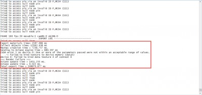

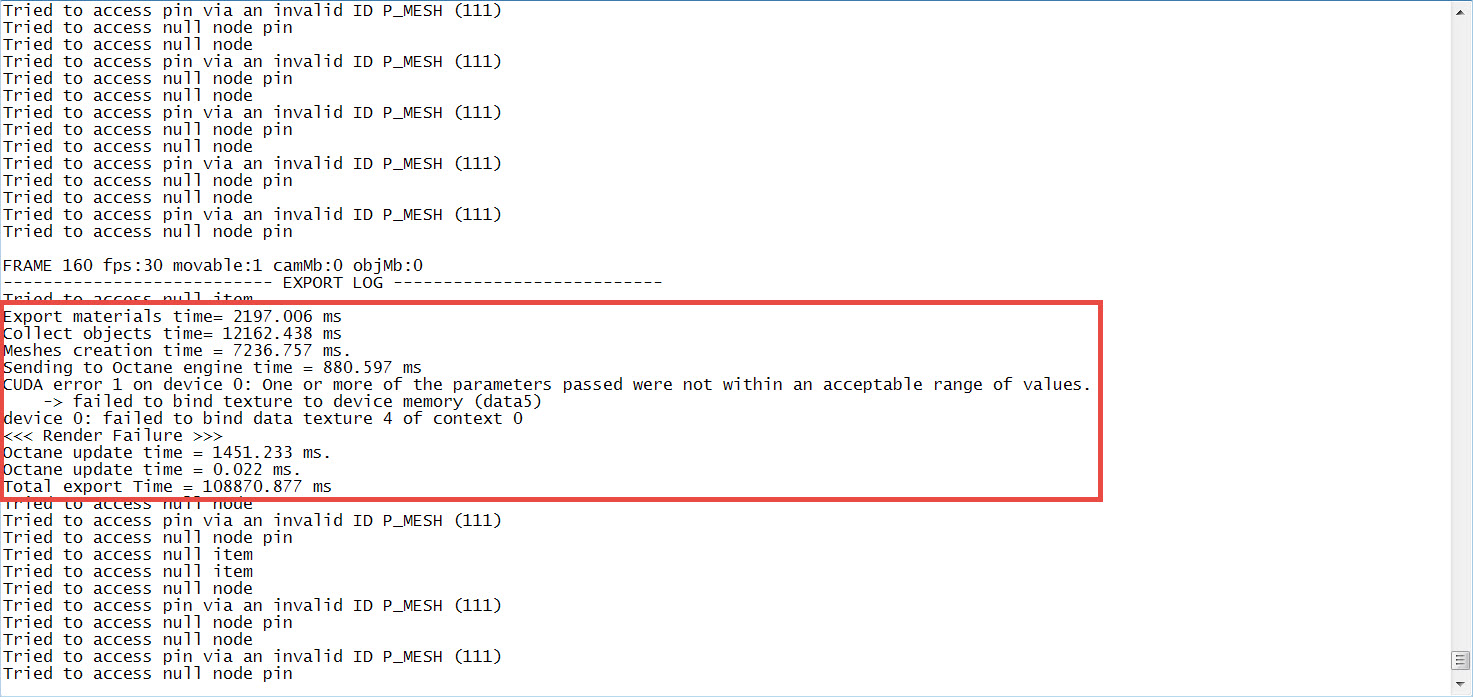

Thanks for your input, here is the log file

Find this section in log. See first 3 times for preparation part. Most biggest time spent on object collect and mesh creation. This means that there is lot of objects(propably crazy amount, because i never saw so long collect times) and it's strangely longer than mesh creation time.

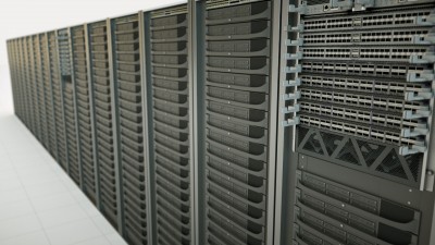

Thanks. I read that post, seems similar, but I'm not even trying to get this to load in the LV.
Strange issue. A lot of times my geometry is coming from other modelers and sources, so hard to control things like triangles and other modeling workflow issues. It's a series limitation for Octane of the geometry that renders fine in Advanced renderer breaks Octane.
But I dont think there's anything that crazy about the individual models in this scene (sample render with Half the objects in it attached). the problem is simply that there appears to be a upper limit to how many of the objects can be in the scene before Octane stops working. So this render was no problem, less than 2 minutes to load and render. But take 1 additional instance of the exact same geometry (well below the max polygon count and below VRam limits) and Octane just stops working.
Very strange, and very scary issue. I've gone to almost all my projects being created and rendered in Octane, but with deadlines looming I continue to wonder how far I can push Octane before it stops working.
