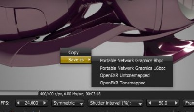

well, for still frame you can just export your scene to standalone and save your render as png 8bpc and untonemapped EXR.
I don't think it's possible in Maya without rendering twice.
But exporting to standalone works smoothly now.

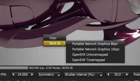

Just tested and works great, cheers.
Quick request to the developers, though. Can we have a 16bit png (or similar) or half float output option from inside Maya.
Cheers again.
