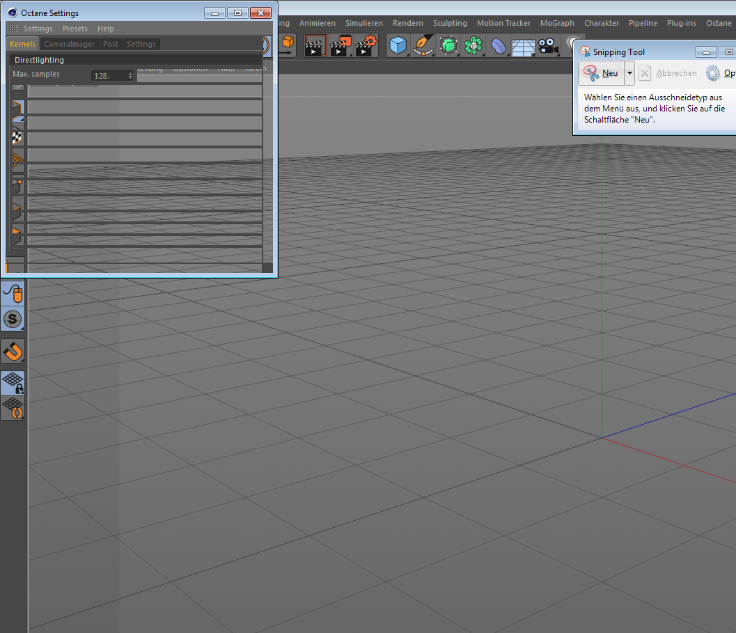

Thats what it looks like after calling Octane Settings from Octane Menu

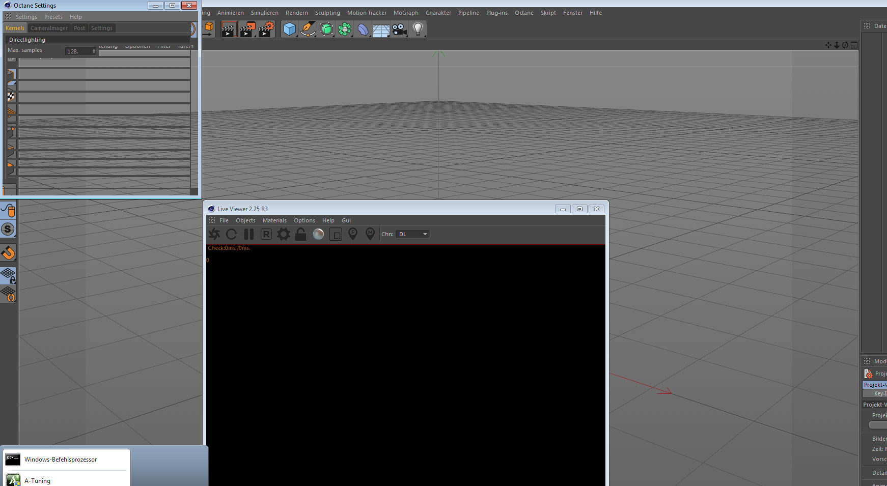

when i call lLV first this happens - see picture
after calling LV first

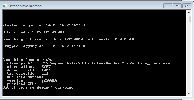

res.rar
res directory packed like it is in /plugins/c4doctane
(618.8 KiB) Downloaded 175 times
console
console
