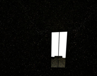

I'm doing this project where I have a housing building with rooms inside and I put a plane in each room to iluminate it while I don't want to see the plane lighten up but want the illumination of the romm.

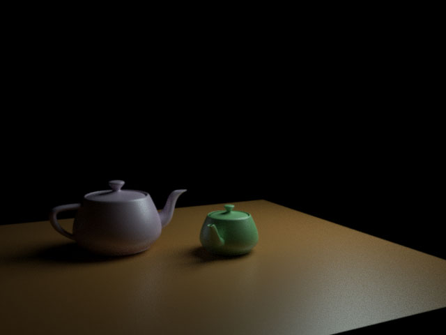

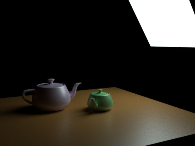

Whe I put opacity to 0 in the emitter material it behaves strange, I did some screencaps. two tests, one with the rooms from the project and another 2 from a testscene with a couple of teapots and a plane. Why aren't my rooms getting illuminated and teapots do? Any clue? Illumination seems to converge but does not.
Thanx in advance!

At the end of the room that's the exterior light coming thru? cause if it's so the problem is with the normalize bool and the power of the light, the celing light is working, it's just not powerful enough compared with the exterior light, you could either lower the exterior or give more temp/power to the ceiling one, when you add opacity to the lights the dimm big time

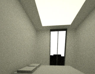

this is a box, lined with materials and an invisible plane mesh emitter pointing down from the ceiling.
simply switch to pathtracing and left to cook for 5 mins.Adjust the emitters power to suit.
Just make sure if your using planes that the normals are pointing in the right direction in your 3D software.

@kubo: That's what I thought and in this example there is black environment. The white color is because it has alpha channel on and jpg turn it to white. I have several planes with 6 light materials (different wavelengths).
When I use only one material it renders right, but when I put all the materials together light illuminates part of the exterior but not the interior of the rooms.
@Jaberwocky: All is as you pointed out. pathtracing, normals right, and cooked for mor than 2000 samples.
