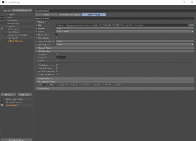

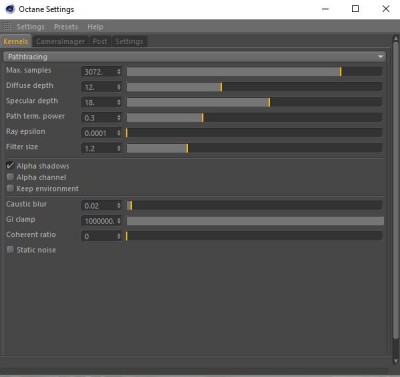

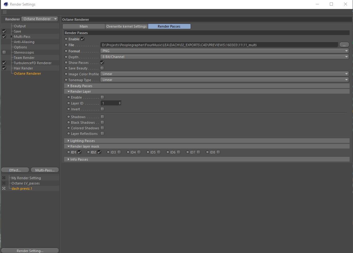

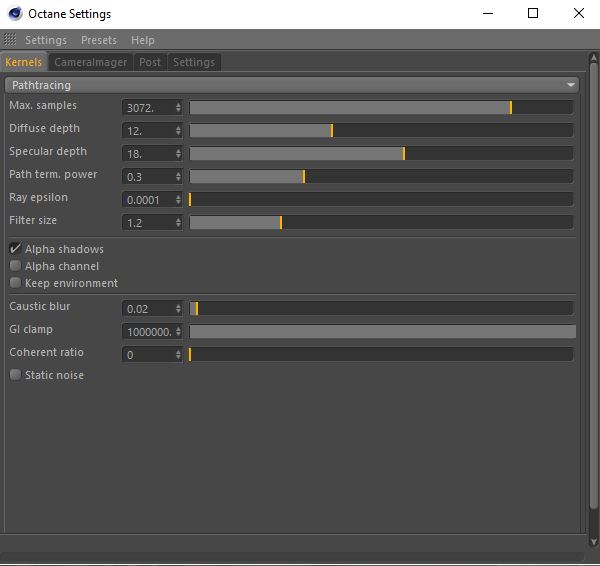

Hey guys,
I am currently working on my first commercial Project using octane and i am testrendering the last couple of days. Now i noticed some obvius transparent edges after I stacked up the render with the multipasses (layer masks).
Can someone help me out here and tell me what im doing wrong or how i can improve the result?
These are my Rendersettings:
Rendersettings01
Rendersettings01
Rendersettings01
Rendersettings01
And here are the files if you wanna test it.
Renderings.rar
Rendered Passes
(6.33 MiB) Downloaded 151 times
all the best & thanks so much in advance!
Joey

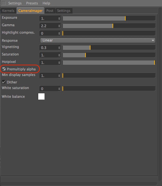

Hi Joey,
I cannot see nothing wrong in your attached files in PS, are you working in AE or other compositing package?
Could you try activating or deactivating the Premultiply alpha option in the Camera Imager tab?
If possible try to use 16bit or 32bit image format ;)
ciao beppe
