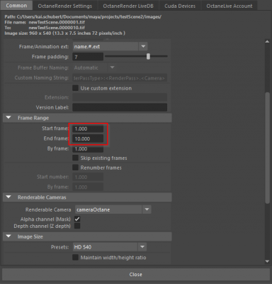

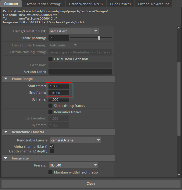

in this example I have 10 frames in my timeline:

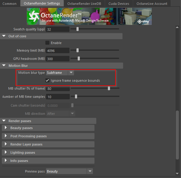

Subframe with ignore option
Subframe MB needs an additional frame at the end of the animation. The less error prone way to do that is to hit the checkbox "Ignore frame sequence bounds".
This enforces to stay in the frame range, but therefore the last frame (10) does not get blurred (no frame 11 to blur with).

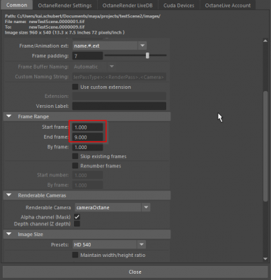

Subframe without ignore option
Without hitting the checkbox you have to limit your framerange yourself, so for 10 frames in the timeline the frame range can be 1-9.
Or you add one more frame in the timeline.

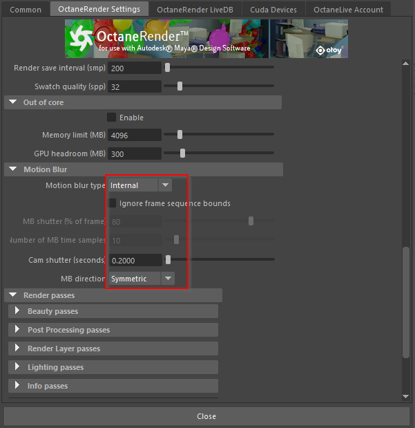

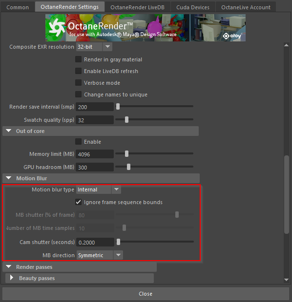

Internal without ignore option
In this MB mode it depends on the option "MB direction":
"After" needs a variable amount of frames after the end frame of the frame range to render.
"Before" needs a variable amount of frames before the start frame of the frame range to render.
"Symmetric" needs a variable amount of frames before the start frame and after the end frame of the frame range.
If you miss to have enough frames in your timeline before and/or after your render frame range,
the plugin prints an error message with this variable amount of needed frames to mayaRenderLog.txt:
Code: Select all
Error: Internal motion blur animation with "Symmetric" direction and 0.2 shutter requires 3 extra frame(s) before the animation's start frame.
Error: Internal motion blur animation with "Symmetric" direction and 0.2 shutter requires 3 extra frame(s) after the animation's end frame.
This way you can see, how many frames you need before/after your frame range.

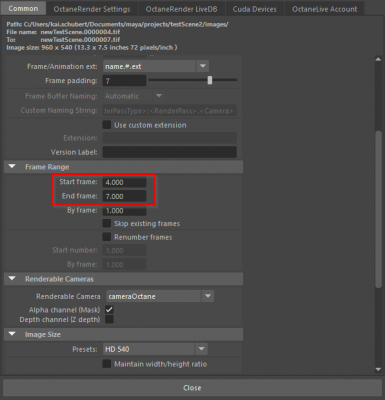

Here it is 3 frames at the beginning and end, so with 10 frames on the timeline, you can set the range to 4-7.
I can as well add 6 frames to the timeline (16 total) and set the range to 4-13.

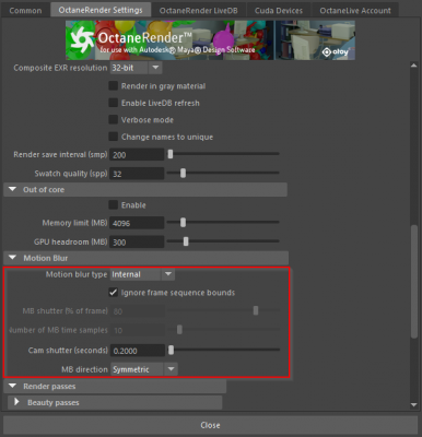

Internal with ignore option
When the ignore checkbox is hit, there are no errors printed to mayaRenderLog.txt and only the available frames (from the timeline) are used for the MB,
so your animation gets rendered, but is less blurred.
