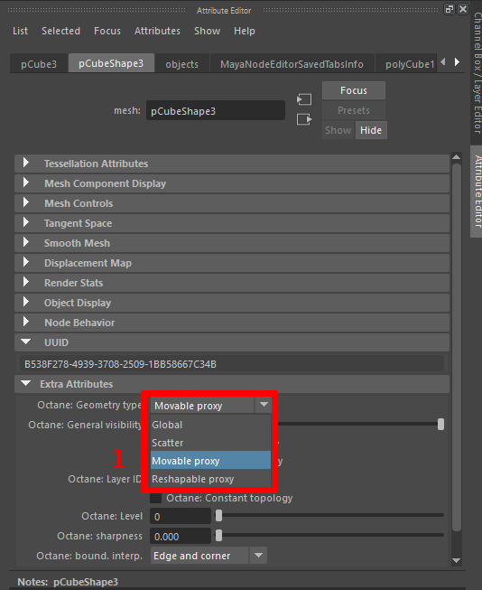

Step 1: Make sure your objects geometry type is something different from "Global". So it can be "Scatter", "Movable proxy" or "Reshapable proxy".

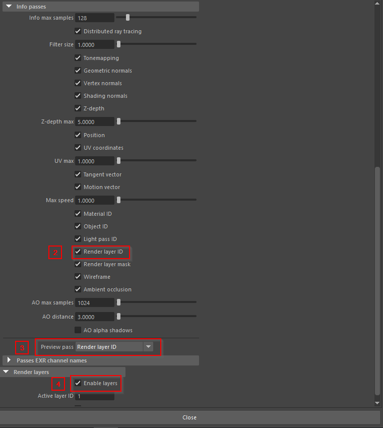

OctaneRender Settings
Step 2: Check "Render Layer ID" in the "info passes" tab, to actually render the Render layer IDs.
Step 3: Then select them as a preview pass to display.
Step 4: Finally, make sure Render layers are enabled.
Now all layers are rendered and changing "Active Layer ID" does not change that, like usually.

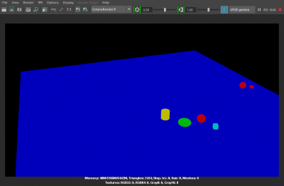

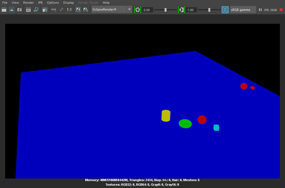

Result:

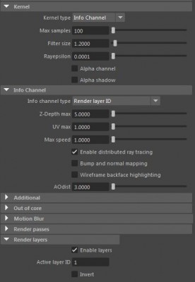

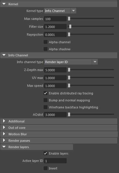

In the meantime, the trick to render a useful render layer id pass/beauty pass is to select an empty render layer and inverse it:
Otherwise for a layerID pass only, a simpler way is to use the Info kernel :
