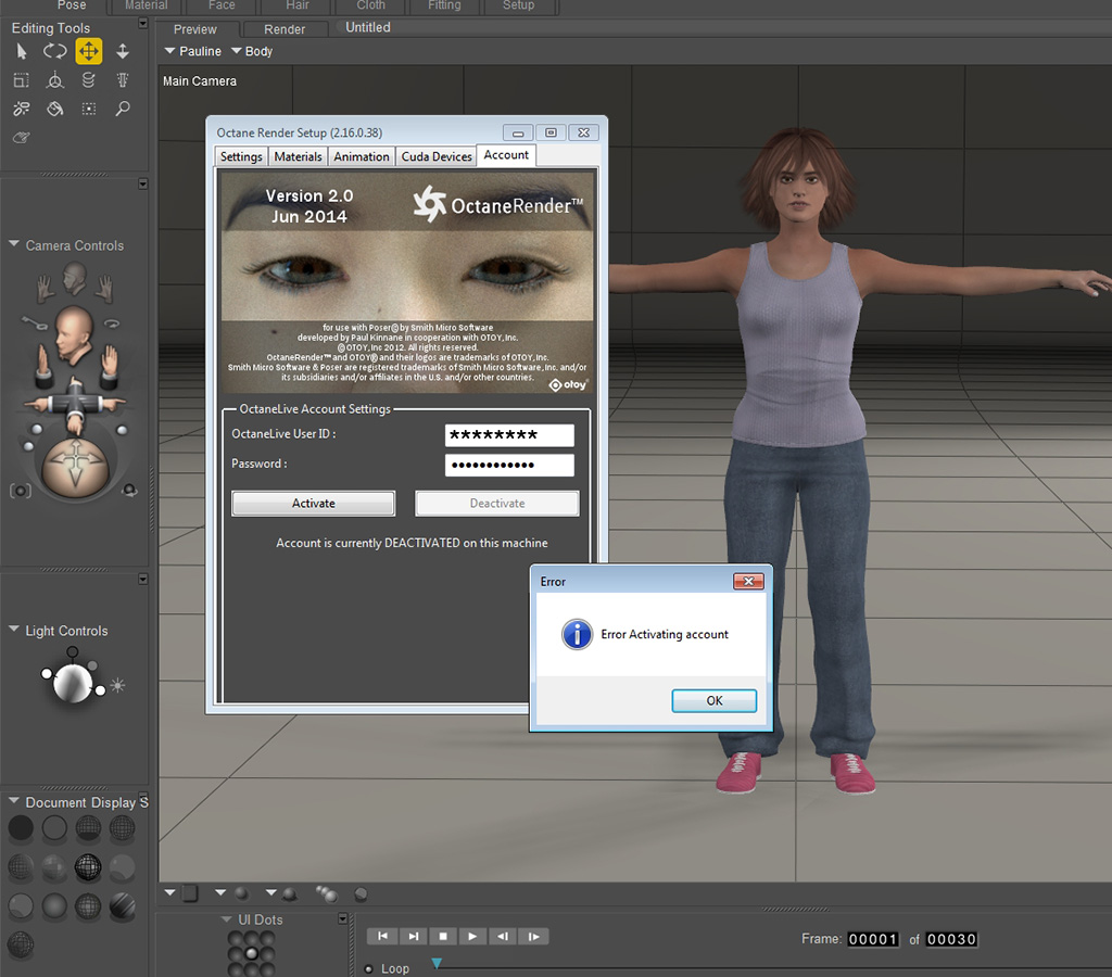

Hi folks. I had the Poser plugin working in Poser Pro 2014 and have recently upgraded to Poser Pro 11. I also updated Octane to 2.25. When I try to render with the plugin in PP11, the activation window pops up (indicating that Octane is deavtivated on my PC) and asks for my Live username and password. When I do that and click on Activate, I get an "error activating account message". Windows 7 is what I am running. Can anyone advise me on this please? Thanks in advance.

Thanks very much Paul for repying. Unfortunately, today I get the same error when I click Activate.
For obvious reasons, I starred out my Live ID in the screengrab.

The plugin version in your screenshot is not Octane 2.25 - it's 2.16. Can you update to the latest STABLE version of the plugin (viewtopic.php?f=45&t=40425) and try again pls.

Thanks Paul. It was two problems, first I had installed the wrong Poser plugin (2.16 instead of 2.25 as you correctly pointed out). But when I installed 2.25 I got the same error message. So instead of entering the Octane Live UserID and Password, I instead entered the Poser Plugin Username and Password. Guess what? it worked fine! Thanks again.

To clarify further Paul, I had accidently installed the Poser 2.25 plugin into PP2014 instead of PP11 and just didn't realize until you pointed it out.
