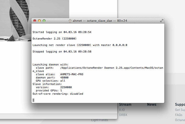

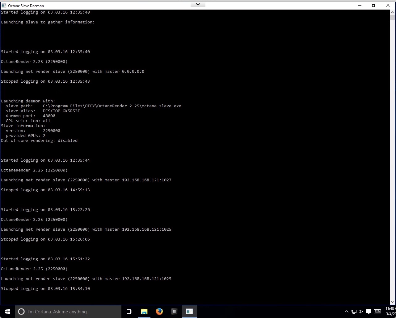

I'm not sure it's a crash on plugin. Looks like a netrender issue on renderer. What happens without net? Do you see some errors on net clients?
Where would I go to look for these errors?aoktar wrote:I'm not sure it's a crash on plugin. Looks like a netrender issue on renderer. What happens without net? Do you see some errors on net clients?

It seems to only occur when Network Rendering in Live Viewer is enabled. If I render to the Picture Viewer with Network Render It does not hang. I could not force it to hang when I had network render disabled.aoktar wrote:Here. Btw are you seeing same without netrender? This is very simple scene and i never see this kind of problems with local gpus.
no errors seem to appear on the slave
