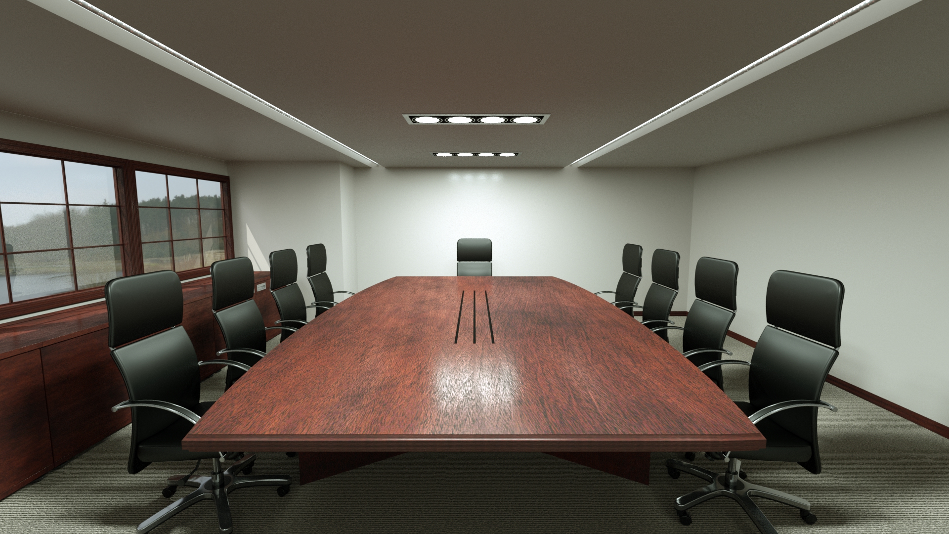

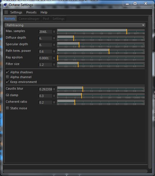

Hi all. I've tried everything I can think of, but can't seem to get rid of the noise in the reflections of my windows. I'm using a glass material from the Octane Live DB and have my max samples cranked up to 2048. In other scenes I've created, window reflection noise has never been an issue. The problem is that this is a 300 frame animation and at the current render settings, I'm looking at 6+ minutes per frame to render...going any higher on the max samples would make the render time inefficient. In other scenes without windows, I've been able to render at 1024 or 1536 max samples in about 2 minutes per frame. I'm hoping there is another setting I can tweak that will reduce the noise (besides de-noising the entire scene in AE). Thanks in advance for any tips.

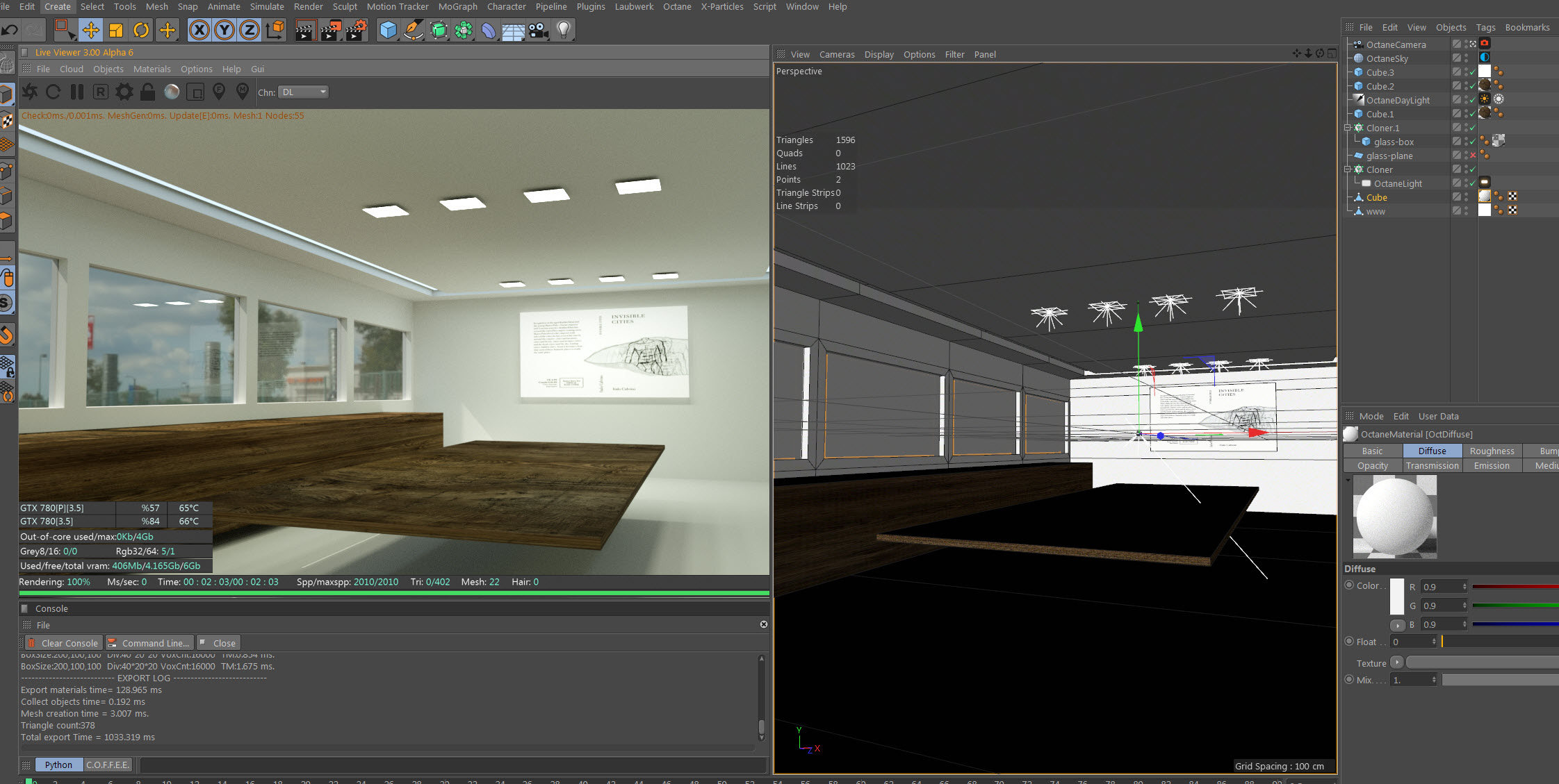

Here is a quick try.
scene:
https://render.otoy.com/plugindownloads ... i-test.rar
