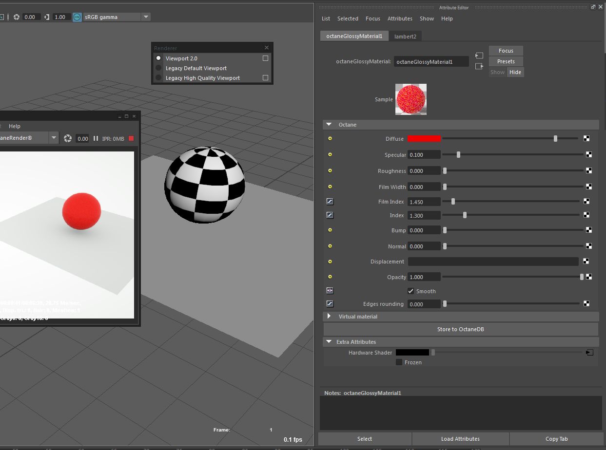

Usage:
- make sure you use viewport 2.0
- create some octane materials for some objects in your scene
- load the script in the mel section of your script editor
- execute the script (ENTER key of the numpad)
- now every Octane material should have a new "hardware shader" attribute in their "extra attribute" section in the attribute editor
- Clic on the little checker of the "hardware shader" attribute of any of your Octane material, it will open the create node window
- chose for example a Maya Blinn material and make it red
- now what you should see in your viewport 2.0 is the red Blinn shader instead of the octane material. The red blinn material only override the Octane material in viewport 2.0, not in other viewport and not at render time obviously
- if you create a new Octane Material, execute the script again (if you use the script regularly just drag and drop it from the script editor to a Maya shelf to make a button)

Thank so much
it work now
last time i use Texture not Shader not work
Use Shader it fine
