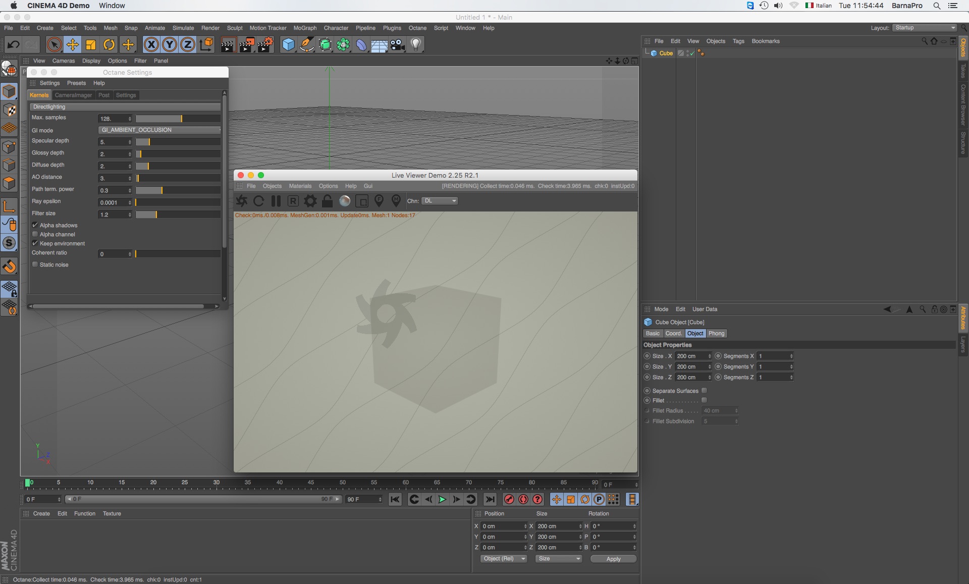

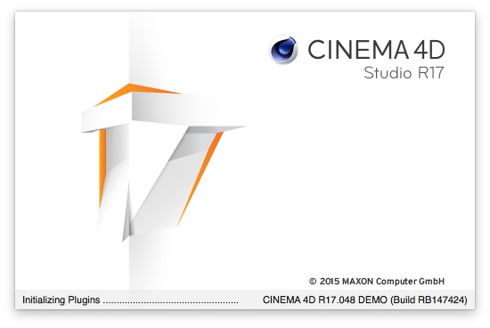

Posts: 10352
Hi muffin3250,
weird, I have just downloaded the R17 Demo, updated to 17.048 and installed the c4dOctane Demo plugin with no issues :roll:
ciao beppe
