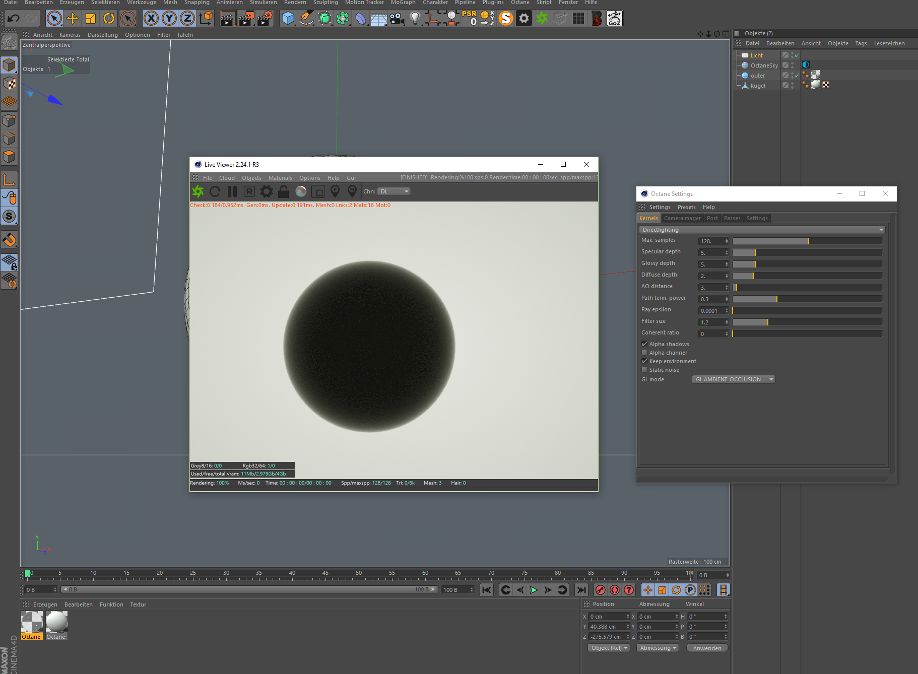

Hi there,
is this a normal behavior with direct lighting or i missing something?! the only way i´ve get rid off the black is if i put the AO slider to 0,01 - not exactly what i want ^^
and switch to a GI mode without AO, pathtracing or pmc is also no option =/
greez
armin

try turning up your specular depth

A scene would be great next time ...
DL & AO works with specular. Is the problem maybe that "Kugel" is inside "outer" and only a tiny bit smaller than "outer"?
