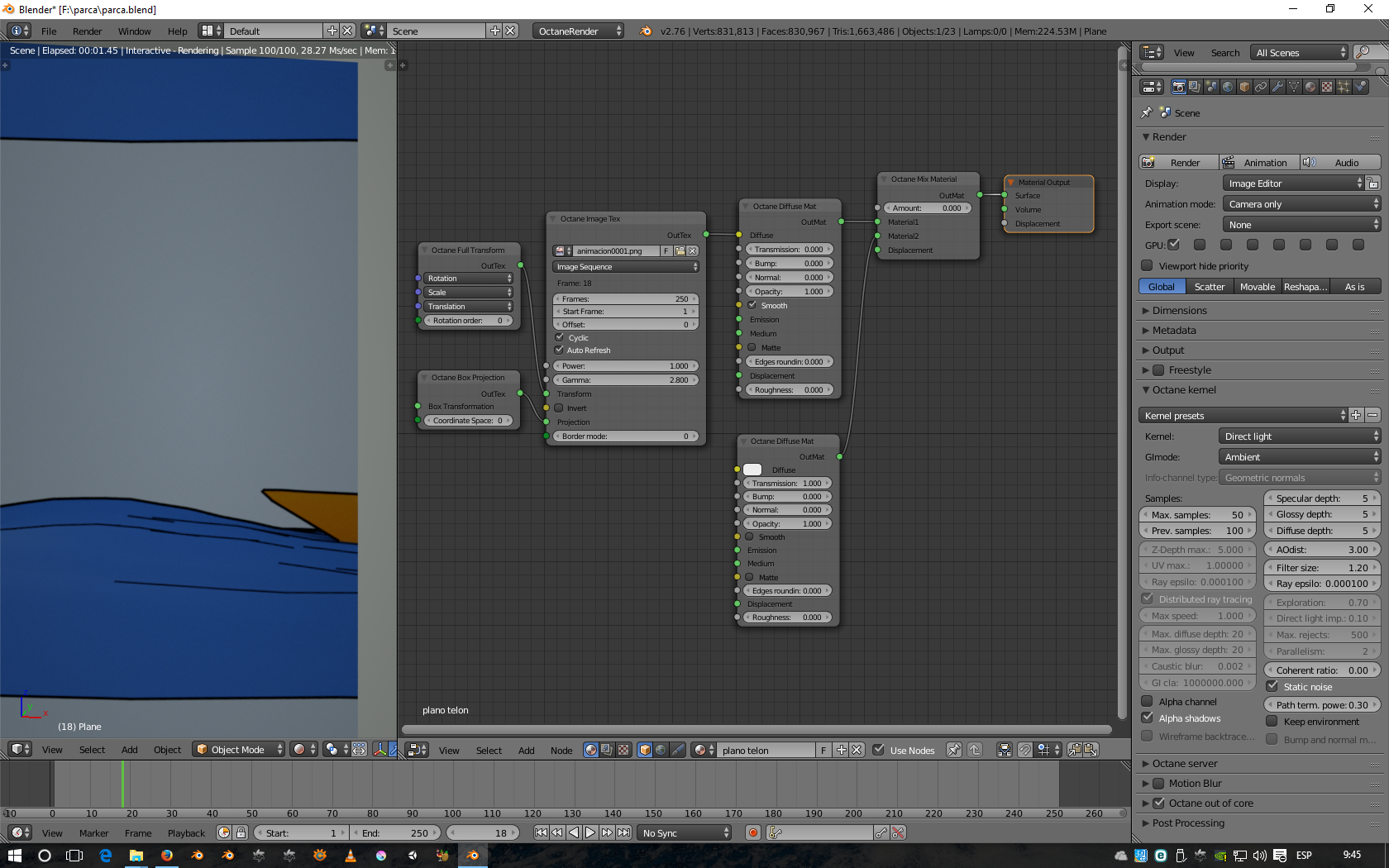

Hello.
I am a texture with octane image tex, with a image sequence. The outTex is the diffuse in "octane diffuse mat" out to mix and out to material output.
At rendering time, the octane blender no increment the frame. It take the first one only.
Some time in preview render update frame, but not into animation render.
Please, any can help me ?
Thanks.

Hi, it is not possible to use animated textures in Blender for as far as I know.
This is a new feature in Octane 3.0 and it is in Alpha testing now.
I hope we get the next update to Blender 2.77 and Octane soon but it need at least a few weeks.
Cheers, mib
