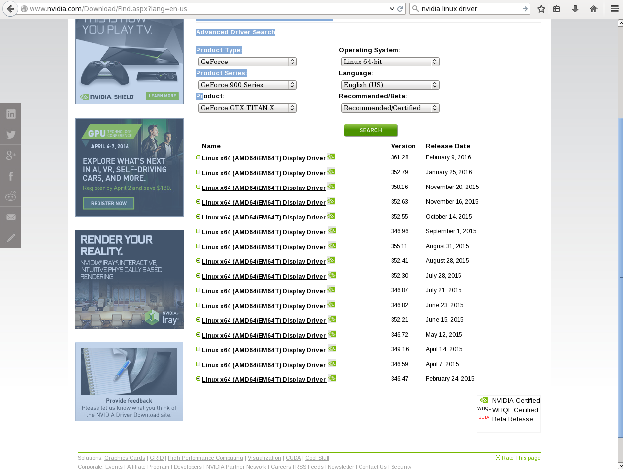

Did you install the Nvidia drivers from the Nvidia site installer? If so, I couldn't see any reference to version 352.79 there. I am actually running 346.22.

- I downloaded the Nvidia driver from their website, installed from command line as needed. Check attached png for Nvidia website driver overview.,
