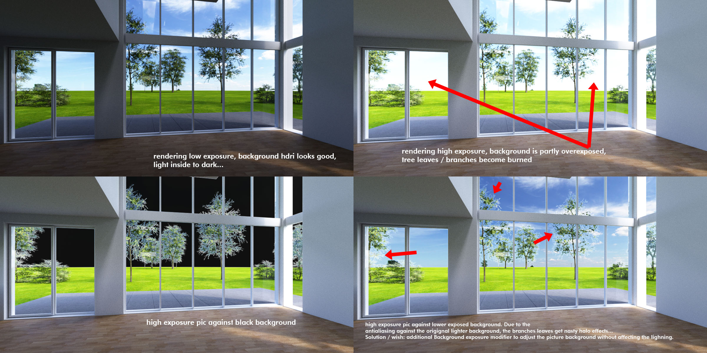

I often experience nasty halo effects around rendered elements (such as trees) which are due to the fact that I use a certain multiplier for my hdri map to archive nice lightning conditions, which result in an overexposed sky.
When composting the rendering in PS with a normal exposed, darker sky, my trees are have a white bluish border, because they are antialiased against the overexposed background.

wish: separate environment option

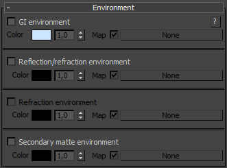

Here is a picture from the vray environment tab...
