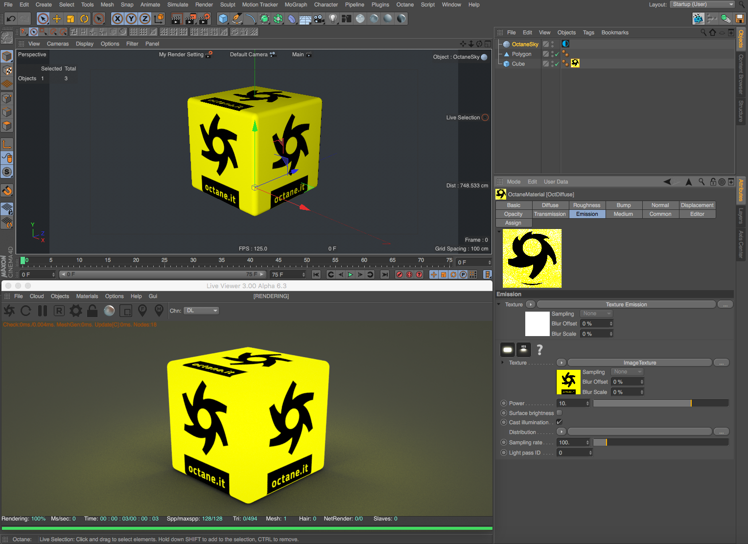

Add texture emission on octane material. Turn off "cast illumination". Put your to image emission->texture->imagetexture.

Hi IgnaceAleya,
look at this scene:
TextureEmission.zip
(76.43 KiB) Downloaded 230 times
