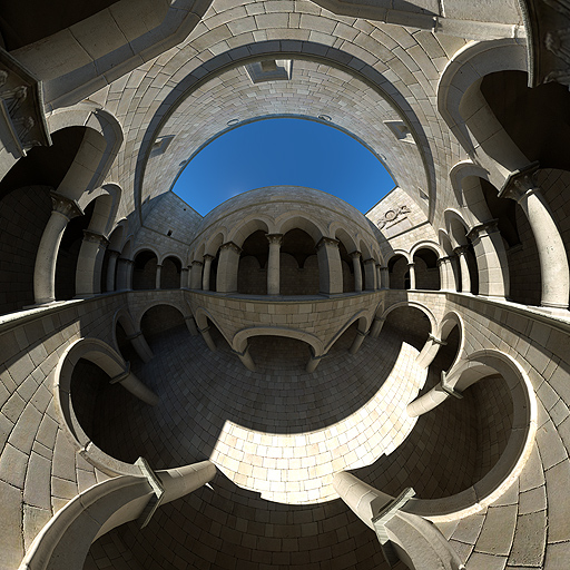

Here is a 270° fisheye of the well-known Sponza scene, using the stereographic mapping function.

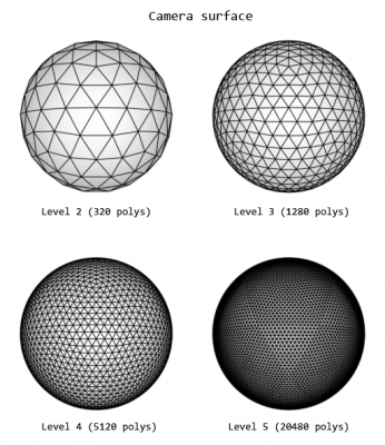

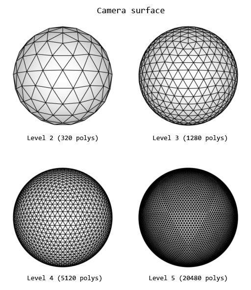

In some circumstances the edges of the polygons making up the sphere start to produce discontinuities in the output. This is where the subdivision level comes in. Here are wireframe views of the camera surface at the various subdivision levels.

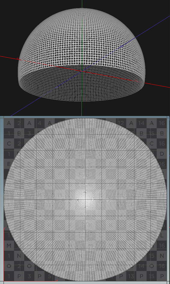

Question:
It is the same process than bake a mirror ball ?
If you use a mesh like my picture in attachement (sphere 210 degree with uv map equidistant)
this will work too ?
jobigoud
Posts: 257
Joined: Sat Aug 15, 2015 1:28 pm
Yes unfortunately the script will not work as is in the latest versions of 3.x, including the release. It's no longer possible for the rays to really "see through" the mesh. Lowering the mesh opacity or making it transparent will result in black. This is to support the primary use case of baking.
There is a solution, using reverse baking and doing point symmetry around the baking position. So that the rays start from the mesh, go towards the sphere center, and then expand towards the scene. The geometry is more complex to set up. I will try to work it out when time permits.
