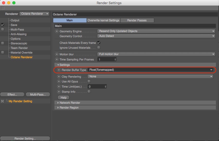

i render output POST multipass (PNG 16-bit) and color range like 8bit color? how to change it? im try setting file with 32 bit for better but cant :cry:

make sure that, in Render Settings / Octane Render, the Render Buffer Type is set to Float(Tunemapped) or Float Buffer and not set to 8 Bit Buffer ;)

bepeg4d wrote:Hi huyrua811,
ciao beppe
tks for support bebeg. I test with float butter or float(tunemapped) but not working . This my post map in c4d output window render and output folder . I set PNG 16 bit + float(tunnemapped). What happen here :(

Don't use PNG . Choose EXR in cinema 4d "save dialog"
