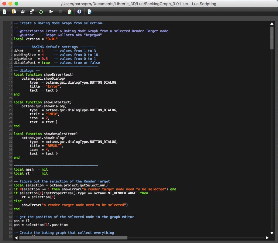

If the script is opened in the Script Editor window, almost on top, it is possible to change some default values for the baking cameras, then, if the script is saved, it can be execute directly from the script menu with the desired default values.

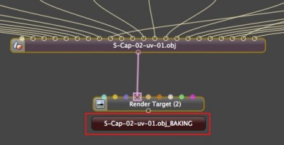

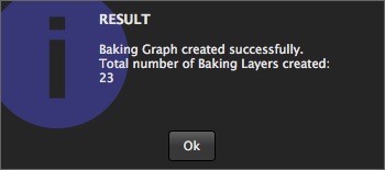

After the script has been executed, a dialog window should inform you about the baking render target created:

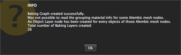

or if an alembic or obj node without material group information was found:
then double click the new node graph just below the render target previously selected:
At the center of the node graph should be visible an annotation node that stores all the materials names with the proper baking ID, a generic copy of the render target just above and a group that stores all the baking render targets:

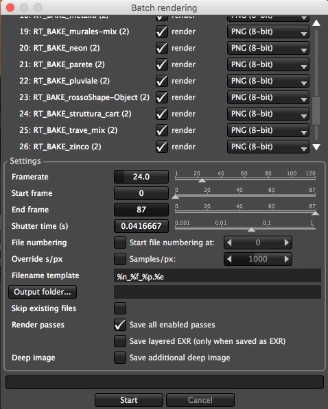

By selecting the generic copy, is possible to fine tune all the settings, like resolution, render passes, kernel settings and so on. Since they are shared with all the other baking render targets, when finished, just select the default Batch rendering script to render all the textures in one go.
