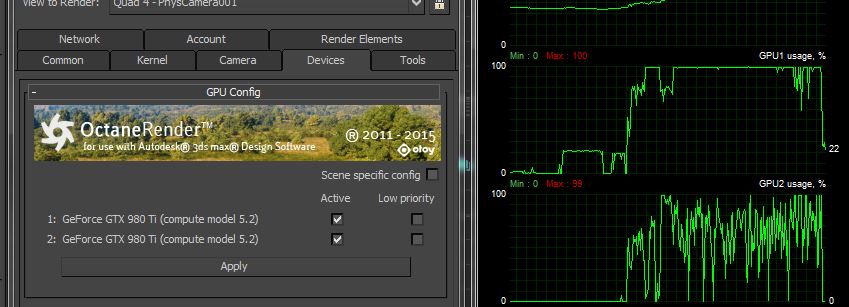

Serious issue with latest version... Serious in terms of buying 2 980tis and getting same performance as 1 980 + 1 680 i had before....
Max plugin cannot utilize both gpus.... in fact having both in full priority is like one of em is full and the other works in 1/3 or half.... I need a fix for this asap, or why on earth i paid for 3ds max plugin on the first place??

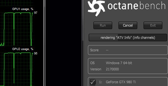

Some more screenshots to show the problem much better. This is not acceptable when u make us pay both standalone and plugin (for those who want to have the plugin). And going back to previous version and losing all the materials and stuff i created so far seems a major bs. In the previous version btw, both gpus hit the 100% usage in case u wondering,
And the proof that octane works perfect in bench..... both gpus identical performance
2 cards....
2 cards....
2 cars.JPG (11.79 KiB) Viewed 4009 times
1 card active
1 card active
1 card active.JPG (12.67 KiB) Viewed 4009 times

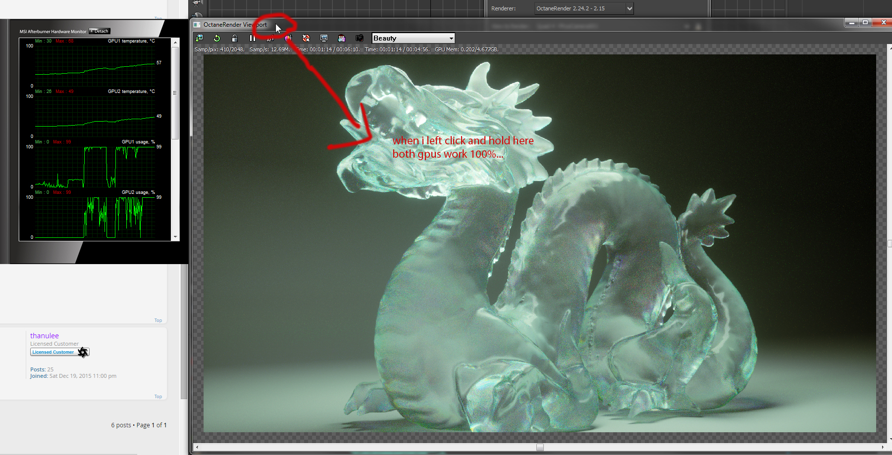

Alright i ll upload the scene when i get home. One other thing i noticed is that if i left click and hold on the frame of the render window, the 2nd gpu goes to 99% and stays stable. If i leave my mouse it does this thing again. In any case i will upload u my scene later. thanks for the help

Sorry for the late reply, i dont have much time during the week. I upload a jpeg to show u something i found out + my scene so u take a look. thanks
link to the scene: https://www.dropbox.com/s/3tqd2hg1lxtaq ... m.max?dl=0
when i click on the edge of the window and hold both gpus go 100% which is very odd.

Hey,
On closer inspection, it seems that some core functionality is placing stress on your GPUs. This is a consequence of limitations with MAX itself (in regards to integrating with Octane). Fortunately, the limitations specific to your issue will be amended, however this will come with Octane 3. With Octane 3 helping to better overcome a lot of the limitations inherent with MAX, this will greatly improve many things across the board.
The focus right now for 2.x is comprehensive bug-fixing - this issue is caused by a consequence of limitations with MAX rather than by an actual bug, so this issue will be resolved as a result of the upgrade to Octane 3.

Well, with the previous plugin there is no such thing as the limitation from max, everything works smoothly. Therefore i do not believe there is something wrong with max, but with the plugin itself. Test it for ur self and let me know.
Speaking of which when is eta of v3 for max? thanks
