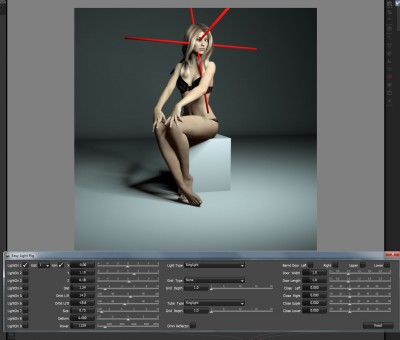

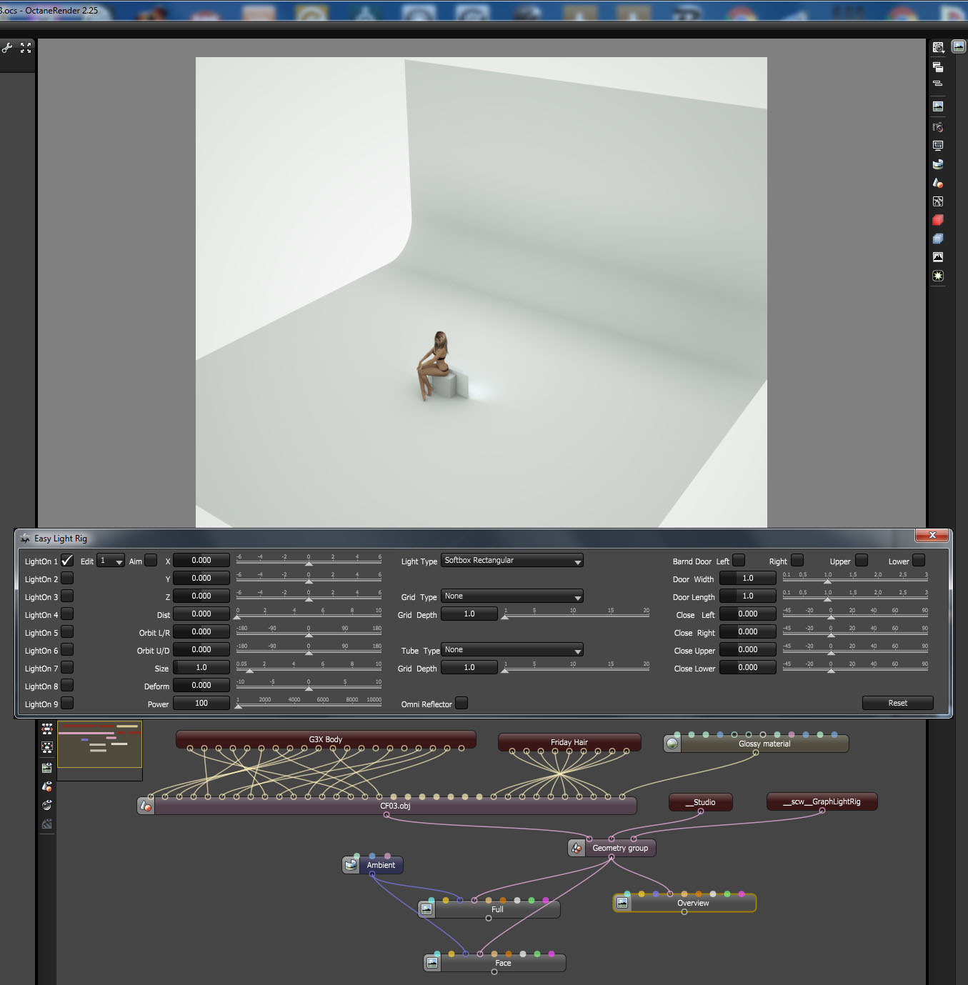

And a short tutorial on how to use it.

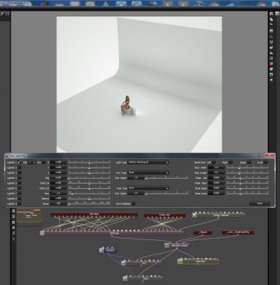

Below you can see my setup from the overview render target.
Just import the light rig and studio if you want it as well.
And why not a cute girl or well.
I usually add one "Overview" rendertarget that has normal texture based light at full power so I can get a god overview.
Then I add a render target for the actual render that has the texture power settings all way down to 0.
If you look closely you will also see the default "softbox" in the center of the scene on top of the box.
That's where lights will appear by default.
You can also see that the script is running, showing the default settings for the light in the scene.
A quick run trough.
The LightOn check boxes turns light on or off.
The Edit drop down is for selecting witch light to edit.
Aim check box turn on the aim cross hair that helps in setting the aim of the light as well as knowing where the light are when out of view from camera..
X,Y,Z Sets the point at witch the light are aimed and the point around witch the lights rotates.
Dist sets how far from the aim point the light are.
Orbit moves light horizontal or vertical around the aim point.
Size is the size of the light.
Deform stretches light vertical or horizontal. A light that not is symmetrical creates shadows harder in one direction than the other.
A sometimes wanted effect.
Power is the power of the light.
Light Type is the type of light.
Grid Type is the type of grid placed in front of light. A grid is used to control how much the light is spread and thus making it more directional thus making shadows harder.
Grid Depth, the larger it goes the more directional the light gets.
Tube Type. Effect is about the same as for a grid if light is small. In a real studio its used to place a controlled area of light on a model.
Tube Length, The longer the more focused.
Omni reflector. Just an ordinary reflector for the omni light.
Barndoors. Can be turned on to control where light goes or to hide the light source from the camera.
Door width and lenght controlls size of the doors.
Rest is to close and open the doors.
And last, a Reset button.
Windows 7 Ultimate 64bit 32Gb RAM. Intel Core i7-5820K [email protected] GHZ. Display uses a Gigabyte GTX 460 1Gb VRAM. Octane uses an EVGA GTX 970 4Gb VRAM.

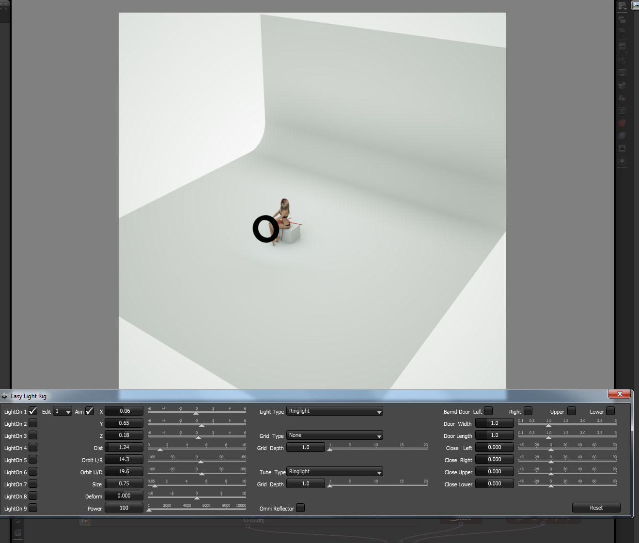

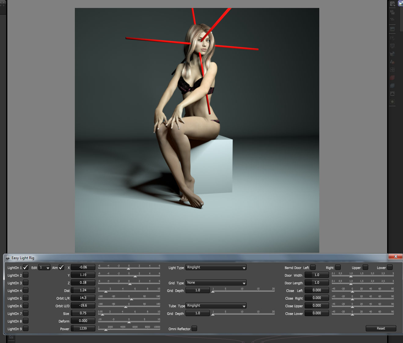

Here I have changed the Light Type to a ringlight.
Adjusted x,y,z to set aim at the abdomen.
Added some distance and and used orbit to move it a bit to the right and higher.

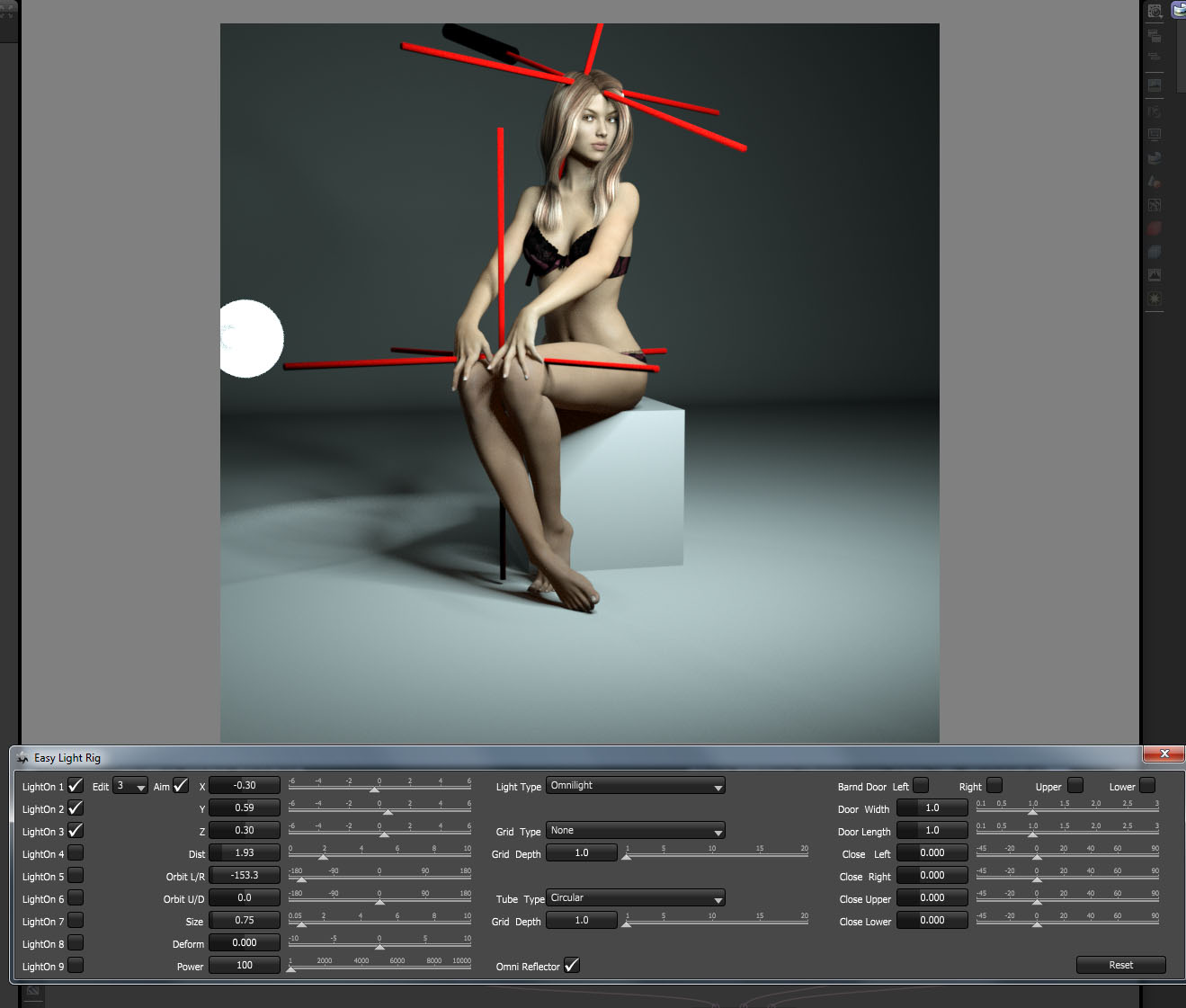

Turned of Aim for Light 1
Added to more lights with Aim on.
One small circular soft box with a long tube for some hair reflections.
And one omni light with reflector for some rim light.

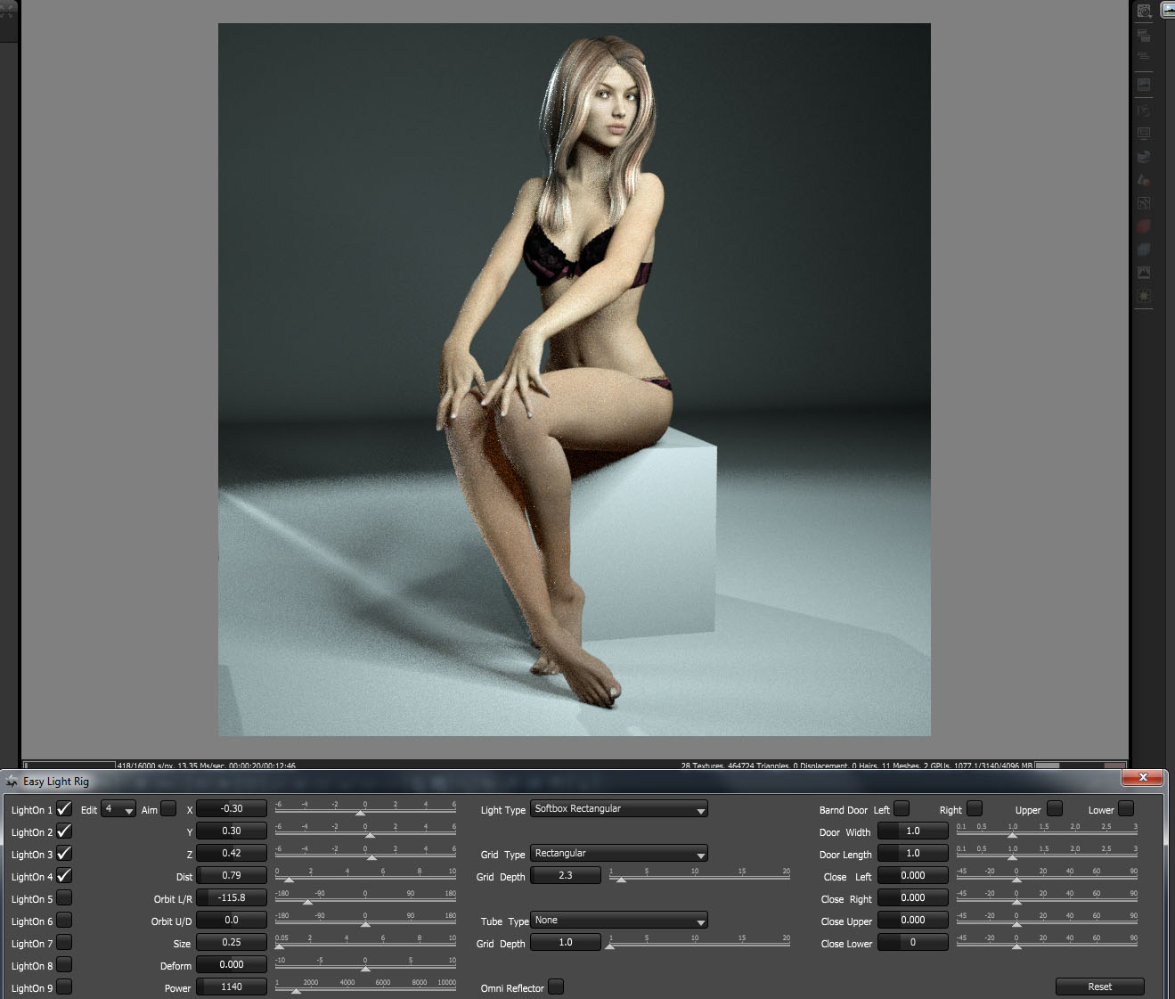

In this image I have added yet another light.
A rectangular soft box with grid that adds some light and rim light to the lower legs.
In this image one can see fireflies appearing.
Small light sources together with gloss materials seems to have that result.

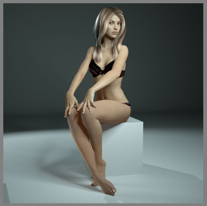

To get rid of the fireflies i switched to the Path Tracing and pulled GI clamp down until they where gone.

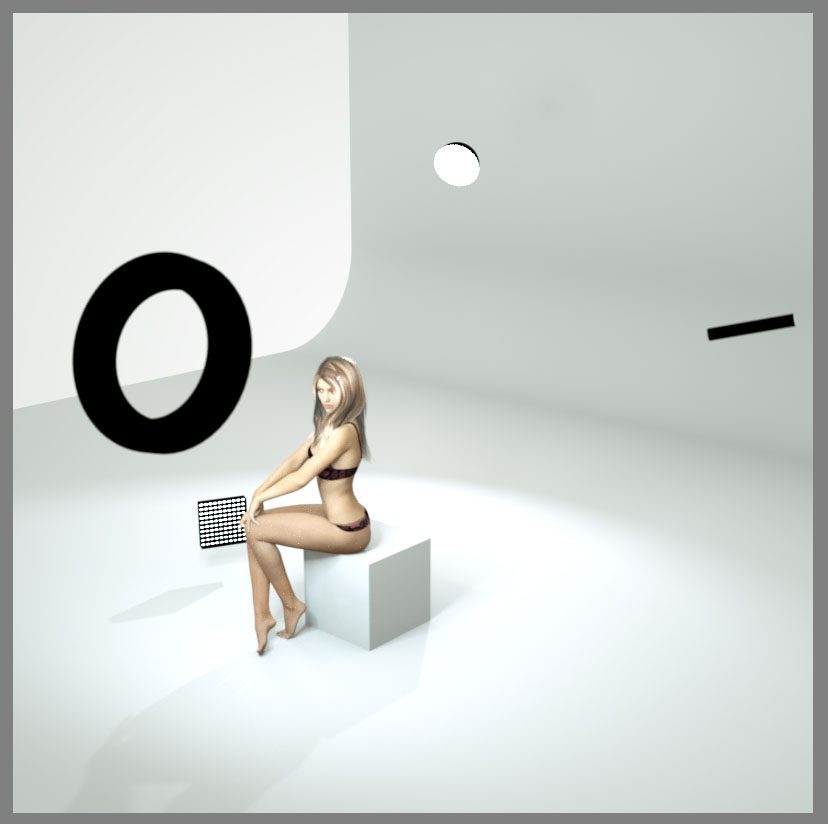

Last an image from the my "Overview" render target where all lights can bee seen.
There is no save in the script but if you make a rig you want to reuse it's just a matter of saving the Light Rig Graph.
Also...
Forgot to remove the Note inside the LightRigs from a previous version that not was controlled by script.
Just ignore it!!!!!!
