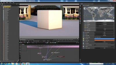

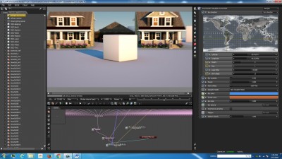

Hi Notiusweb,
in my opinion, it's far more easy to create your camera animation in your host app and export it via alembic, beside modifying the camera with Lua in standalone :roll:
here is a simple example of a zoomed camera exported from C4D to standalone via alembic:
CameraZoomMB-or.orbx.zip
(610.65 KiB) Downloaded 138 times
ciao beppe

I see, okay, then I can layer any other scenery components I want, and they will be included in that alembic cam movement. Great!
Grazie ancora! ;)
