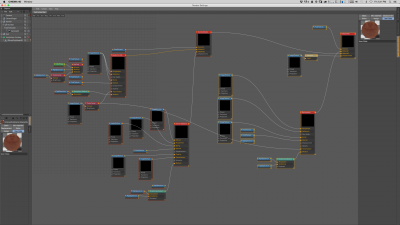

Third you have your backscatter layer which helps with the sss, Here is a preview of the node graph:

A very realistic job! I wish the Node Graph was of a higher res as the details would be a good guide.

TonyBoy wrote:A very realistic job! I wish the Node Graph was of a higher res as the details would be a good guide.
Me too!

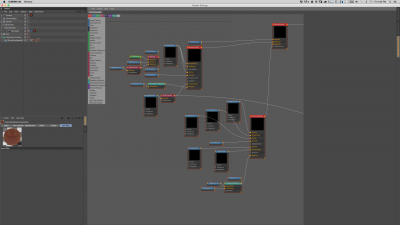

Sure thing guys,
Here is the dermis/epidermis

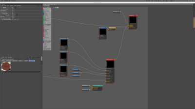

the backscatter mixed into the mixed dermis and epidermis

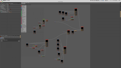

all together

Some questions though: Whats with the float texture in the normal port? Why that?
And whats with all the other nodes, which are not connected to anything? Are those backups?
jonidunno
Posts: 18
Joined: Thu Nov 13, 2014 8:02 am
DinoMuhic wrote:Very interesting! Thanks for sharing!
Of course,
The float texture are not even being used I didn't have a normal map for those ports, I should kill them for cleanliness...
and yes the other detached nodes are back up nodes from when I was R&D 'ing there are some that aren't even in the screen grab. Just wanted to make sure I could go back before I went too far ;)
and there is a lot more to it then what the node tree is showing you... there are all the values inside the sss, reflectivity, roughness, etc to consider. I just want to share a breif overview with you all. I highly recommend taking a look at that tutorial I left at the top if your interested in learning further, it is very in depth.
